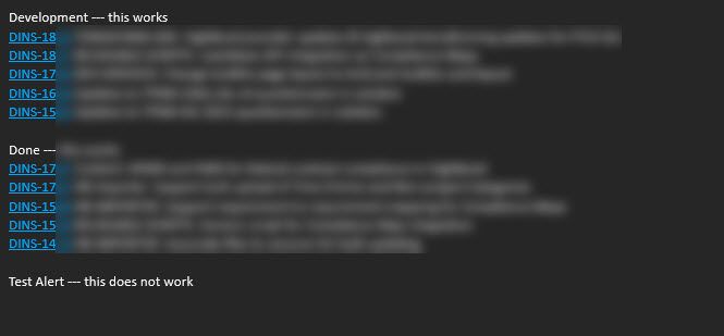

Below is the script I use. I'm able to filer by status.name, but that same functionality does not apply to issue.customfield_16276.value. I'm looking for a solution to the filtering issue or a workaround to generate the same result. The custom field in this scenario is used in the JQL query just as an FYI. Thoughts?
Development --- this works
{{#lookupIssues}}
{{#if(status.name.startsWith("Development"))}}
<a href="{{url}}">{{key}}</a> {{summary}}
Done --- this works
{{#lookupIssues}}
{{#if(status.name.startsWith("Done"))}}
Test Alert --- this does not work
{{#lookupIssues}}
{{#if(issue.customfield_16276.value.startsWith("Amber"))}}

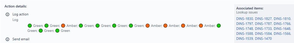

Okay, let's confirm the custom field contains what you expect first.  Please add an action to write this to the audit log after your lookup issues action:
{{#lookupIssues}}{{customfield_16276.value}}{{^last}}; {{/}}{{/}}
That should produce a list of your custom field values, separated by semicolons.  If you see anything else, either the field id is incorrect or it contains something unexpected.
jalewis
March 28, 2023
I was able to confirm a list of statuses using the query above. How do I use this information to filter the list of issues by Amber?Capture.JPG
Bill Sheboy
March 28, 2023
Ah...something is different with this one, as that "value" may be an object and not a text value.  Otherwise it could not possibly display those icons with the data...
Or do your drop-down values contain icons at the front of each value?
If they have the icons, you may want to try endsWith() instead of startsWith()

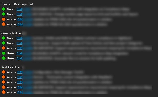

You are the man Bill. I made that change and was able to filter my issues by Amber. Just to recap for anyone following:
  • I was unable to filter a custom field in an automated email
  • After consulting Bill, it was determine drop-down had icons in front of each value
  • By updating startsWith() to endsWith(), the issue filter worked.
Below is the revised code used in the automation email and a screenshot of the final result. Thanks again Bill.
Issues in Development
{{#lookupIssues}}
{{fields.customfield_16276}} <a href="{{url}}">{{key}}</a> {{summary}}
Completed Issues
{{#lookupIssues}}
Red Alert Issues
{{#lookupIssues}}
{{#if(customfield_16276.value.endsWith("Amber"))}}
