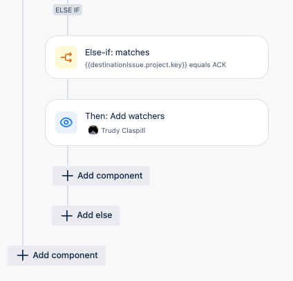

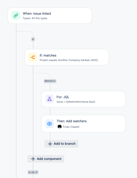

To do this you would have to create a multiple project scoped rule from the Global Automations page. The scope would either need to be All Projects or you would need to pick Project A and any other specific projects that you care about where issues might be linked to the Project A issues.
You would use the Issue Linked trigger. With that you get smart values for accessing both issues that are linked.
You could use an If-Else block to check if the trigger issue is in Project A, then branch to the other issue and add yourself as a watcher. Else check if the other issue is in Project A, and if it is then edit the trigger issue to add yourself as a watcher.
In this example I used the ACK project (that's the project key) for Project A.
