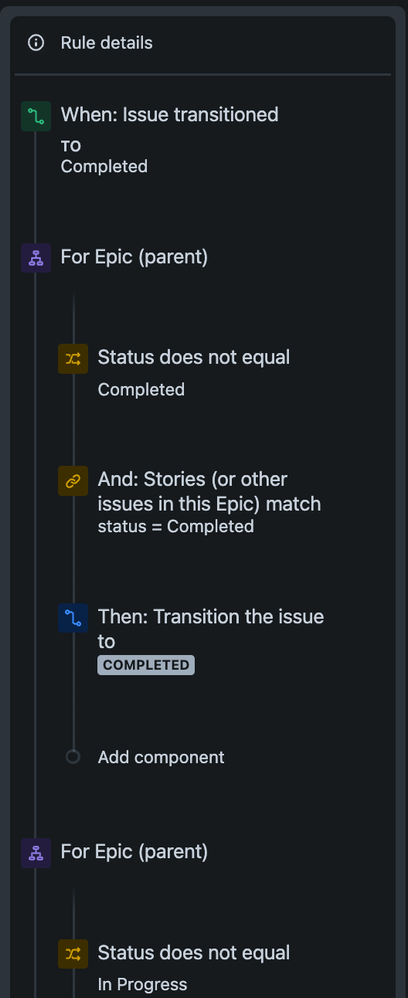

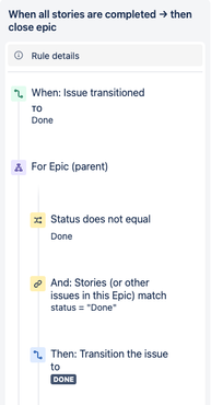

If you go to Project settings > Automation and look under Library there is a rule called "When all stories are completed → then close epic" that you can use as a starting point, just change the statuses to fit both of your use cases.

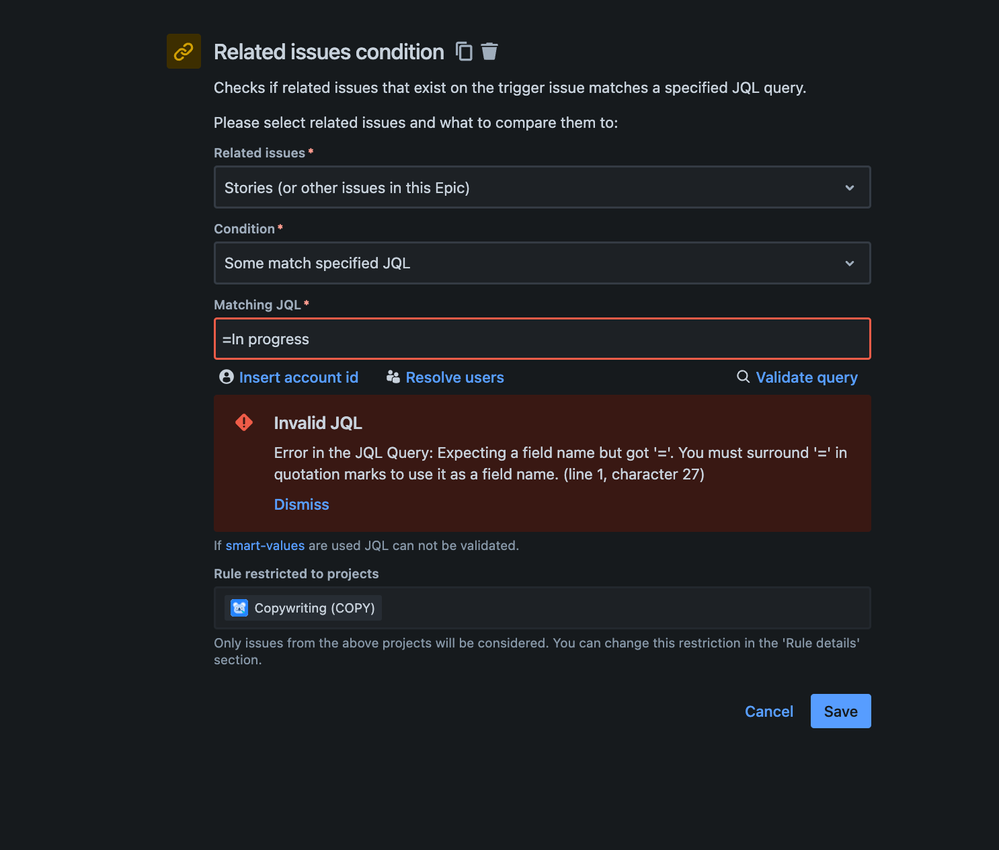

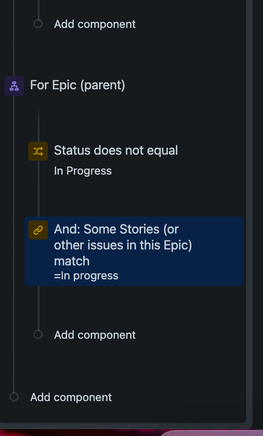

Hi @Mikael Sandberg thank you so much! I am having an issue with the in-progress part of this now? It is rejecting my JQL. Could you take a look?Screen Shot 2023-04-12 at 12.07.58 PM.pngScreen Shot 2023-04-12 at 12.08.06 PM.pngScreen Shot 2023-04-12 at 12.08.19 PM.png

Mikael Sandberg
April 12, 2023
Your JQL is missing status = "In progress", using just = "In progress" is not a valid JQL.
When you did the test, did you move a story/task to completed or an epic?

April 12, 2023
@Mikael Sandberg  I just watched this video: https://www.youtube.com/watch?v=Y5u_i9z06zg
And it seems like the way its set up is doing the inverse? I.e when epic is moved to completed, it moves all child issues to completed? Vs ,  I want to epic to move to completed when all child issues are done?
The one epic is dependent on all child issues to be complete
Child issues must all equal = completed before the epic can move to completed
Since the child issues all happen at different times, some could be completed before others, but again -- the epic should not move to the complete status until all child issues are done.
Mikael Sandberg
April 12, 2023
The example I posted above should only transition the epic if all stories/tasks in it are in the done/completed status, that is what the second condition in the epic branch is checking, the "And: Stories (or other issues in this Epic)" part.
The video that you found is indeed showing the inverse when the epic is moved to done then move all children too.

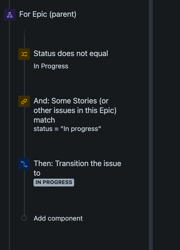

What I need help with now (promise I am almost done) --
For the epic workflow there is only three statuses: backlog, in progress, completed. We have now finished the automation for syncing with completed.
For the task work flow there is the following in-progress statuses:
* In-progress
* Edits needed
* ready for review
I'd like for the Epic task to recognize that if it's child issues are in one of these statuses, it should remain in "in progress" on its own workflow. I've attached what I tried to do, but it didn't work. Additionally, I think I may need or statements for JQL but am unsure how to do that? please let me know if my thinking is correct, or if I need to make updates.
thank you again for your patience/help
Like Mikael Sandberg likes this
Breanna Williams
April 12, 2023

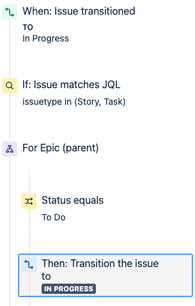

Mikael Sandberg
April 12, 2023
Something like this should do the trick:
In this case I have added a condition to only look for Stories or Tasks that are transitioning, and then transition the epic only if it is on the To Do status. Because you want to move the epic when the first story/task is transitioned there is not need to check that stories/tasks within the epic is in a specific status.
For you I would just add the other statuses that you have for stories/tasks to the initial trigger, assuming that you can move to any of them from any of the other statuses.

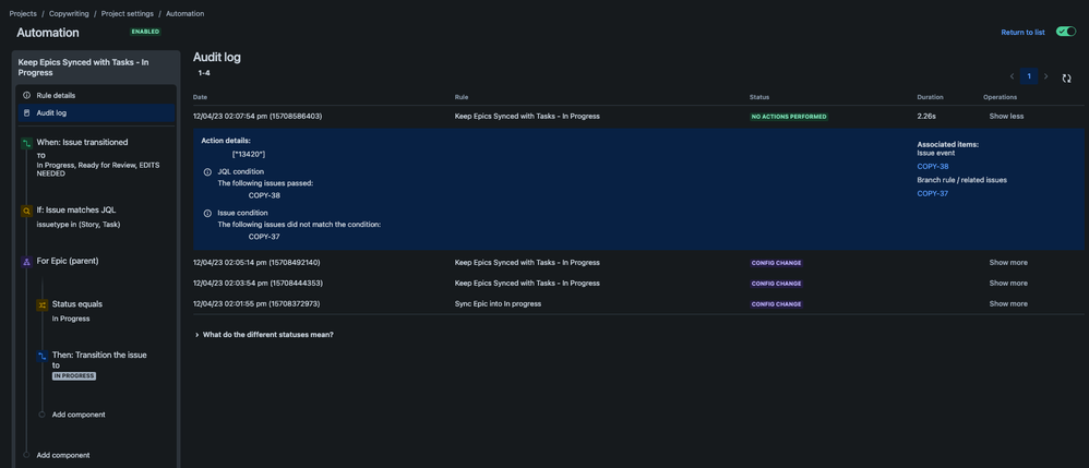

@Mikael Sandberg Screenshot of audit log since it is saying no actions performedScreen Shot 2023-04-12 at 2.09.12 PM.png
Mikael Sandberg
April 12, 2023
On the Epic branch, change the condition that checks the status, because the way you have it configured right now the epic would have to be status = In Progress in order to transition it to In Progress.
