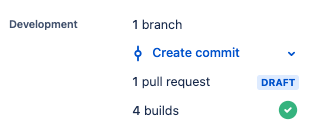

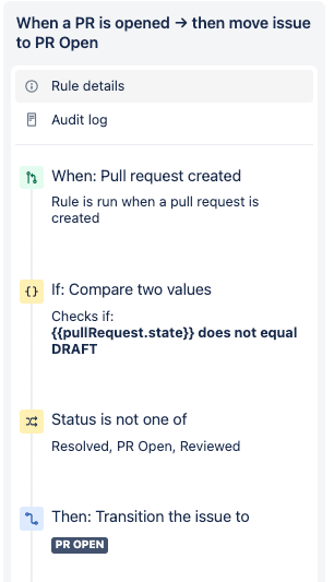

We have 2 columns on sprint board which are 'In Progress' and 'PR Open'. I have automation setup so that when a PR is opened, the ticket automatically transitions to 'PR Open' status and column.
When a draft PR is open, I want the ticket to remain 'In Progress' but this isn't happening, what am I doing wrong? I thought adding the check on the pull request state would work, but it doesn't. I've tried 'DRAFT' and 'Draft' to identify if it's an issue with the casing but it's not.
I'm trying to work around the lack of functionality which would be fixed by https://jira.atlassian.com/browse/JRACLOUD-72888, which we have been waiting years forScreenshot 2023-09-26 at 08.52.54.pngScreenshot 2023-09-26 at 08.53.12.png

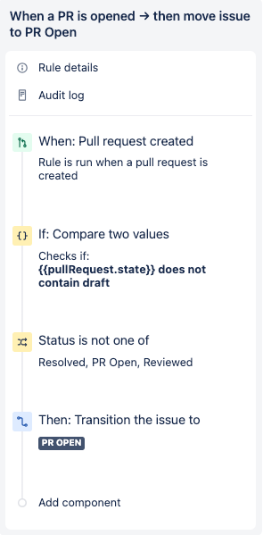

Thanks to the above I have identified a solution which works:

Bill Sheboy
September 26, 2023
Hi @Kara Nadarajah
What if after the trigger, you write to the audit log the value of {{pullRequest.state}} to confirm the value?  That may help you identify what needs to be tested in the condition.
I wonder if that is an enumeration, and there is a lower attribute that could be checked.
Kind regards,
Bill
Kara Nadarajah
September 27, 2023
Thanks! I tried that and it looks like the case for 'DRAFT' is actually 'draft' so I've updated my automation rule again and hope this works next time the rule is run.
Like Bill Sheboy likes this
Bill Sheboy
September 27, 2023
Well done, and thanks for posting that in the open suggestion as well!  That will benefit the community...and perhaps Atlassian will update the documentation to match what you found for the additional value in that field :^)
Kara Nadarajah
September 27, 2023
I've had to disable it unfortunately...it's had the unintended consequence of preventing any tickets with a true open PR from transitioning to 'PR Open' status when they are no longer in draft and these tickets are now remaining 'In Progress'.

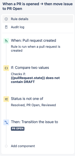

Bert van Dijk _TMC_nl_
September 26, 2023
Hi @Kara Nadarajah ,
What if you use the "Does not contain" option instead of the "does not equal" option in the if statement?
Kind regards,
Bert
Kara Nadarajah
September 26, 2023
Thanks, I tried but it hasn't worked either. The status has still been updated to PR Open.Screenshot 2023-09-26 at 15.43.18.png
