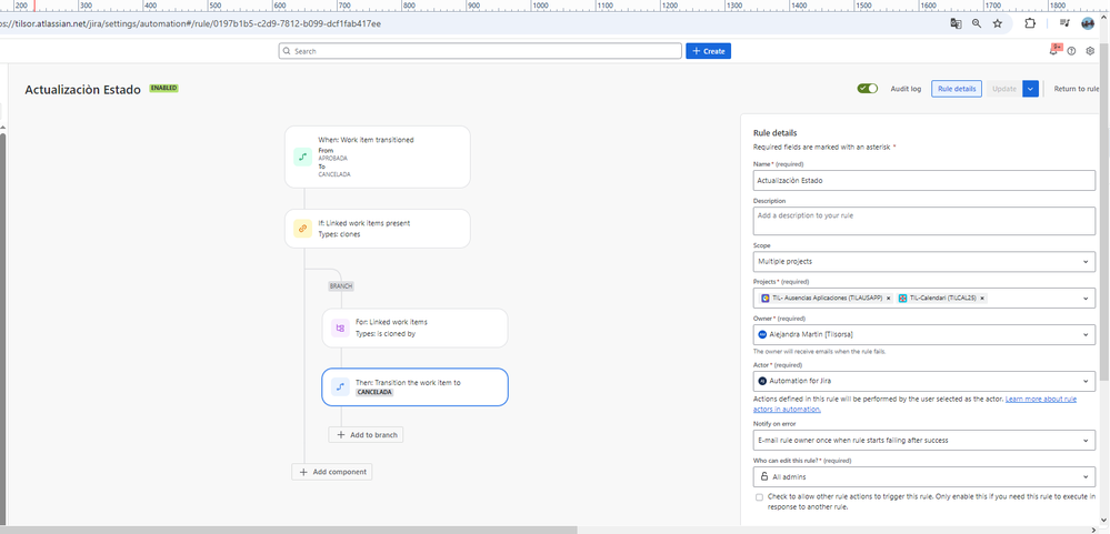

Hi Bill, scope is both project (1 and 2).

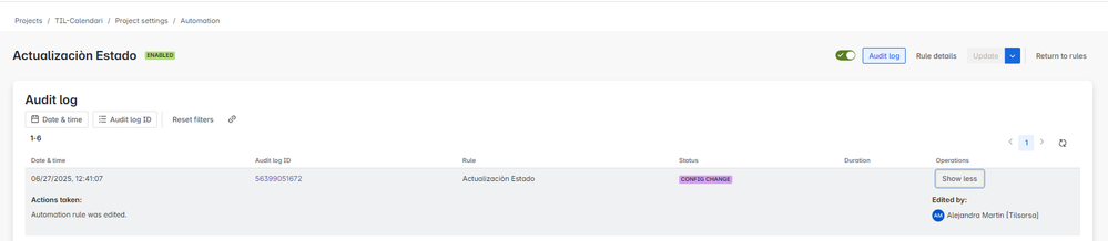

Please post an image of the audit log details showing the rule execution, expanding the areas at the right side.  This will help compare to the rule image for which steps and work items processed.

Hi Bill, thanks for your  update. I think rule is not triggered because, audit log  not show rule execution, only setup changes.

Based on that image, your rule is stored in a single project and so is not multiple project scope.  That may explain why it is not triggering.
Please show the rule details to confirm this.

Hi Bill, I upload rule completly, as you see is for both projects

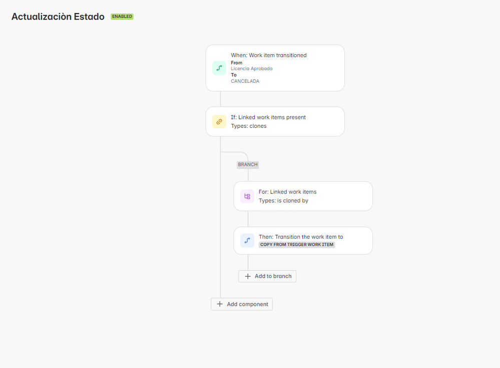

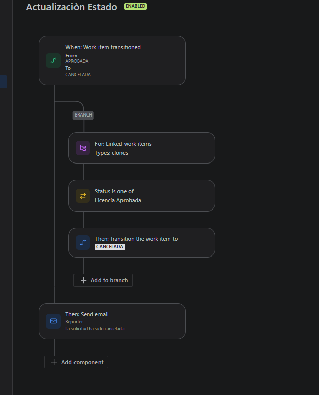

Alejandra Martin
June 30, 2025
Hi Bill, Britimage.pngHi Bill, Britta. I was trying and trying but finally I got it! It works,
Thanks for your help and your ideas

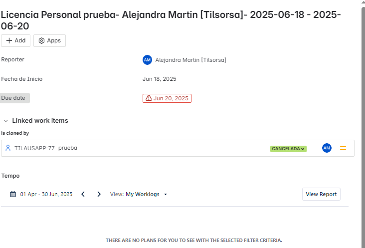

Hi Brita, thanks for your answer. I made the rule but seems to be not work. This is the cloend issued in Project. 2  In Linked Work items refer the original work item of project 1. PRoject 1 is cancelled.
Automation is active for those 2 projects, ant not show error

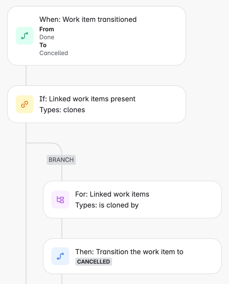

Brita Moorus
June 27, 2025
Hi, @Alejandra Martin! 👋
You could solve that using the following steps:
  • Trigger: When work item is transitioned from Done to Cancelled.
  • Related work items condition: Check that the work item has a work item link of type "clone" (to ensure that it has a cloned work item).
  • Branch rule/related work items: For Linked work items that have cloned link type.
  • Transition work item: Transition work item to Cancelled status (you can copy that from trigger work item).
Hope this helps! ✨
