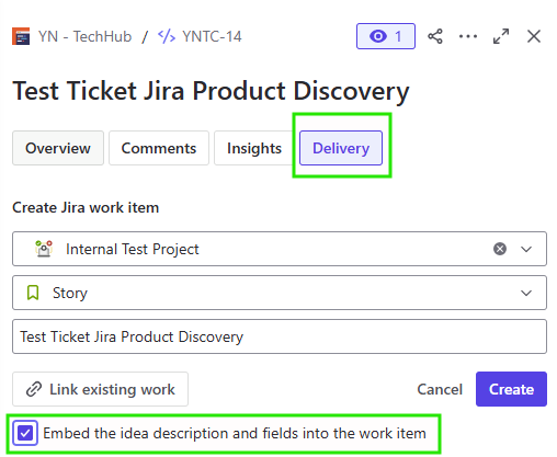

we are using Jira Product Discovery to document all our ideas. Once an idea is fully defined, we directly create a delivery ticket from the Jira Product Discovery issue so that everything is nicely linked together.
Example - how the delivery ticket is created from Product Discovery

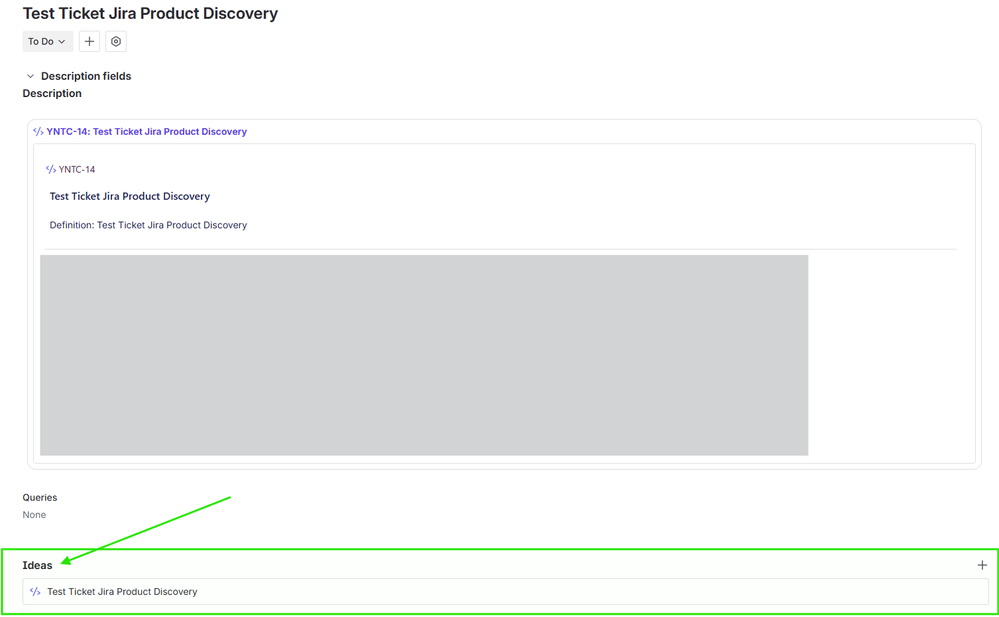

Example - end result of the delivery ticket linking the Discovery Ticket
Now I’d like to set up an automation that updates the status of the idea in Jira Product Discovery whenever the status of the delivery ticket changes in Jira.
I’ve already seen solutions that work with connected work items, but this doesn’t work for me because ideas created in Jira Product Discovery and their linked delivery tickets are not connected as “connected work items.” Instead, they are linked in a different way (idea → delivery ticket), as shown in my last screenshot.

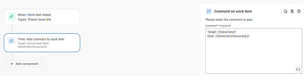

Here is what you could do with automation:
  • Trigger on Idea linked to Delivery work item
  • Link the items with a regular link (behind the scene), keeping the JPD Idea link
  • Then build automation as normal: On status change of the Delivery work Item
The automation trigger for Idea linked is a bit tricky, something you just need to know:
Use the Polaris issue link type to detect the link. What I did here is comment the triggering and destination issue to see which is which.
Issue = Delivery
Destination = Idea
Using this you can link them together via the regular link. A workaround, but the only thing I can come up with.

Okay, thanks. Now I have the problem that {{destinationIssue.key}} doesn’t work in the comments. It gives me an empty output, meaning it doesn’t write the key into the comment.
Jeroen Poismans
October 7, 2025
Make sure you are looking at the comments of the correct work item (idea or delivery).
