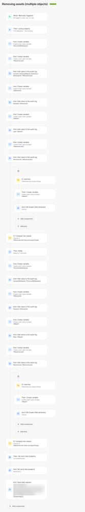

What you should do is actually to create an artificial loop by stacking loop actions one after the other and then call automation to itself using webhook, again and again.
If you do it right, you could squeeze many iterations within a single rule, which will save you a bunch of rule runs.

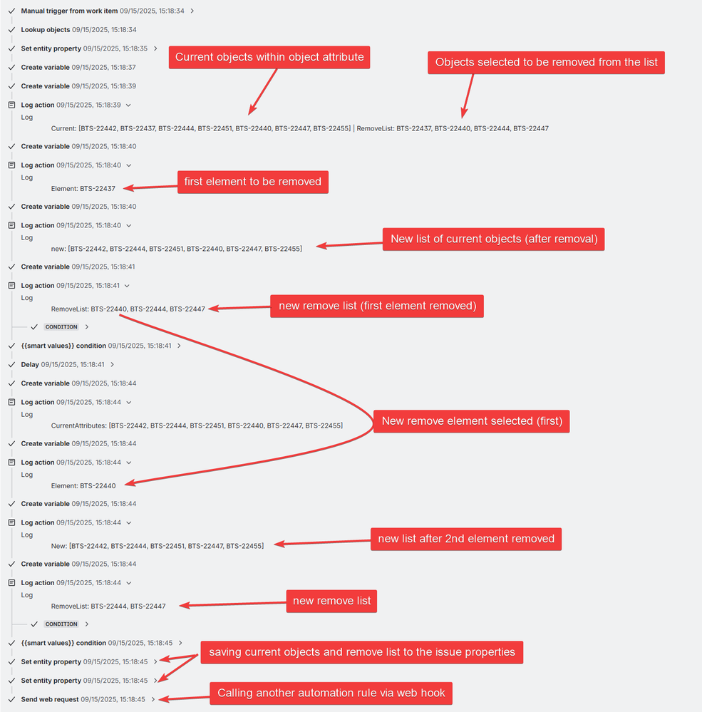

For example, in my case, I had to update object attribute on my asset object in a way that will remove only selected objects from the attribute and leave the rest intact.
I made this possible by using 2 automation rules, because first one is triggered by field value changed and the second one is triggered by a web hook.
So the first one goes through objects and can resolve for up to 10 objects, and if more than that is selected, the second rule is called.
Second rule can also handle 10 objects, and if that's not enough it'll call itself again until everything is done.
My process could be even more optimized by removing some unnecessary log actions which could give me some more space for more useful actions and allow me even more than 10 objects within single rule run.

I used issue properties to store data in between rule runs.
Here is image of my rule.
logs:
it's a bit complex to explain it in this way, but I hope you got the point.
The whole point is in creating a fake loop (manual loop) and use IF's and functions like first, remove, trim... to edit lists of objects, elements, numbers, whatever and then take out only those you need.

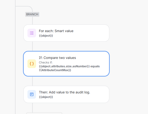

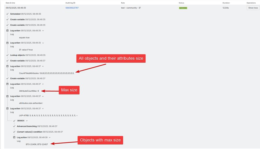

I've recreated your automation rule and tried with multiple different approaches. It seems that Jira automation won't recognize smart value inside nested functions or more likely, inside lookup object list with nested functions inside IF.
Because everything works before that, all variables are correct and available, but it doesn't work except with a branch.
Here is a branch I made and it returns correct results:
Create an advance branch against lookupobjects smart variable.
Then add IF as displayed on image above.
Print object if true.
Here are results:
I know you said you would like to avoid branch because of execution time, but unfortunately, I wasn't able to find better solution.
