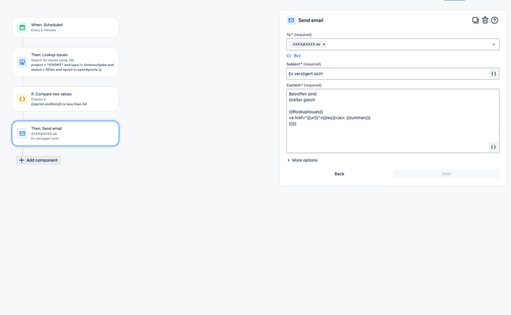

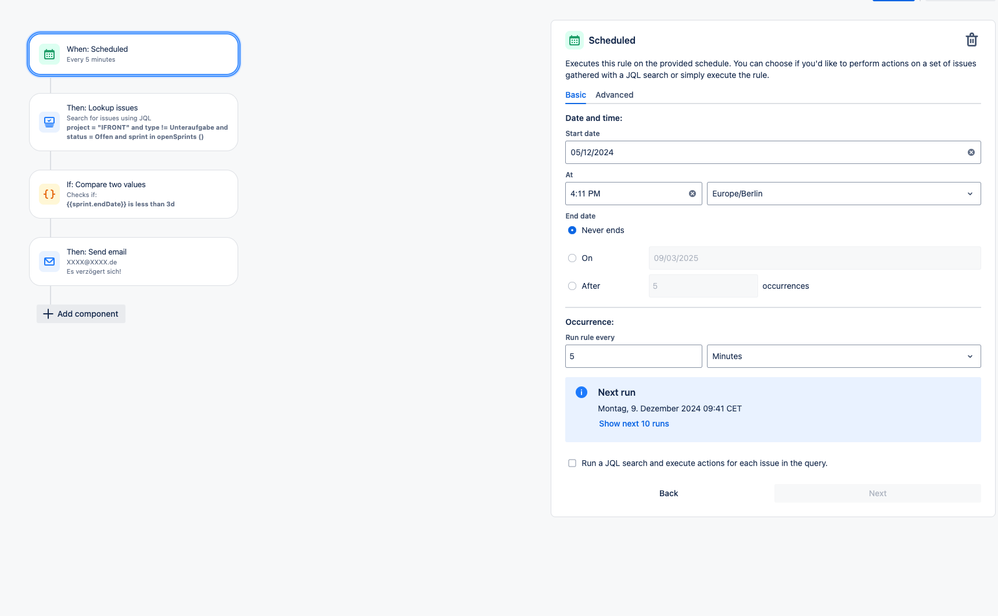

Hello everyone,
I have a new topic I am working on and I would need some assistance on one question, as my current solution doesn't work as intended.
Use Case: I want to setup an automation which sends out an E-Mail to stakeholders, if there are tickets in stauts "open" in the currently running sprint and the sprint only has 3 days left, to inform them that these tickets may not be completed.
Current solution:
PS: The 5 minutes is just for testing!
Problem: My issue is, that the E-Mail is sent out even if the sprint end date is not close to remaining 3 days.
I think the issue is, that the smart value for {{sprint.endDate}} isn't usable if I don't use "Sprint" as a trigger? Is this so?
Does anyone have an idea how to slove my Use-Case? :)
Thanks in advance!
Konstantin

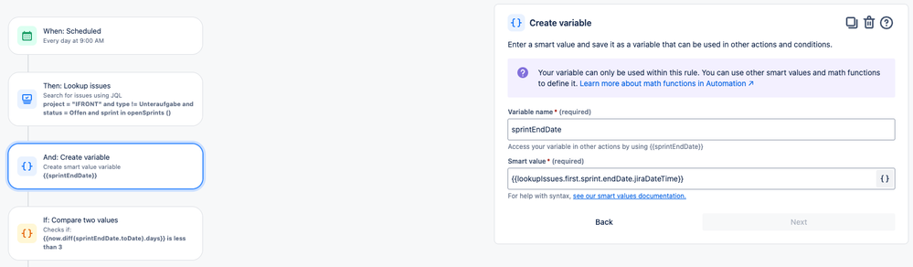

I managed to solve it myself after a few hours :) Thanks for your hints, they helped me!
My solution was to create a variable with the lookup on the sprint End Date of the first issue. I then needed to format the variable with a ".toDate" and could then use the compare action:
Thanks a lot for your help!

Bill Sheboy
December 9, 2024
The created variable you show will contain a list of values if the first issue from the lookup results has ever been in multiple sprints.  This will certainly make the condition work in unexpected ways.
This is why I suggested the method using smart value, list filtering to get the active sprint's end date:
https://community.atlassian.com/t5/Jira-questions/Re-Automation-Send-out-scheduled-E-Mail-when-tickets-i/qaq-p/2890489/comment-id/1073562#M1073562

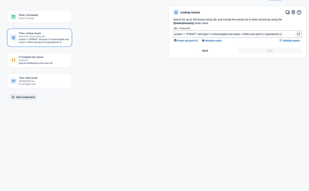

one question here. I am performing the lookup on "openSprints()" with is defined as "Search for issues that are assigned to a sprint that was started, but has not yet been completed." (https://support.atlassian.com/jira-software-cloud/docs/jql-functions/#openSprints--
My project always only has one active sprint and previous sprints are always completed. So in this scenario the check on "openSprints()" should be enough or am I misunderstanding something?
Thanks!

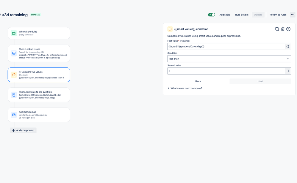

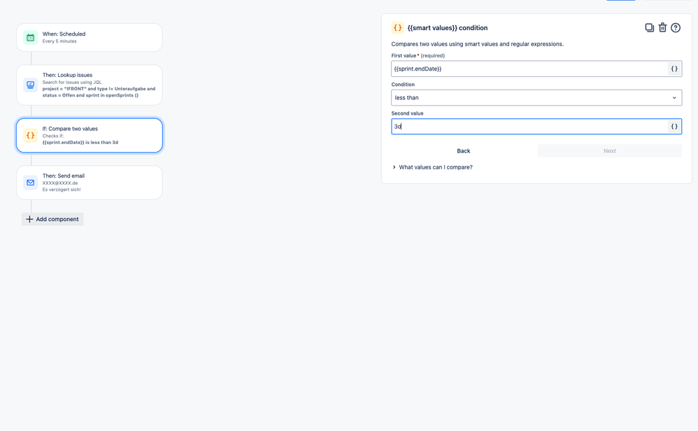

Marc -Devoteam-
December 9, 2024
Hi @Konstantin Siegert
This will be feasible using a date difference smart value option.
{{now.diff(spint.endDate).days}} less then 3, you don't specify days in the second value just a number.
Or use {{now.diff(spint.endDate).days.abs}}
This is depending the positive or negative output of the smart clause.

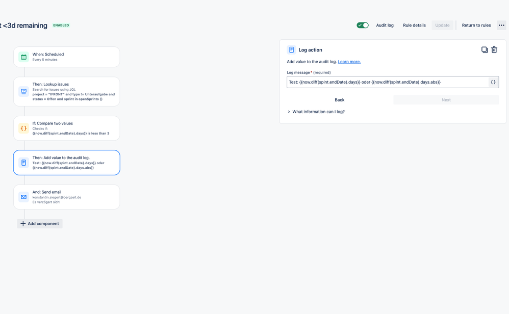

add a log action in your automation to check the output.

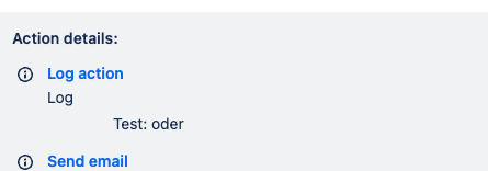

Konstantin Siegert
December 9, 2024
Hey @Marc -Devoteam-
thanks for your quick answer :)
I tried your comment, but I'm not sure if I configured everything correct?
I tried to find out how to configure the Log Action, but the output is empty for both values?
