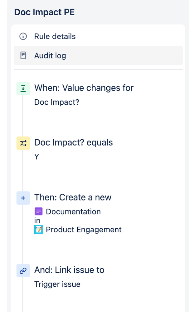

We are trying to figure out how to create an issue in a specific project when a field is set to Y on a feature across all our other projects and then link that feature to the newly created issue in the specific project.
Is that doable?
Jordan Trinklein
July 26, 2023
@Mikael Sandberg I actually got most of the way there. I wired up this rule and it created the issue in the specified project like it was supposed to, but it didn't perform the AND trigger at the end, which was to automatically link the trigger issue to the newly created issue. Do you see anything wrong with how I have it?Screenshot 2023-07-26 at 4.14.01 PM.png
