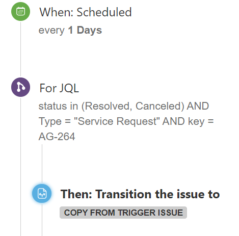

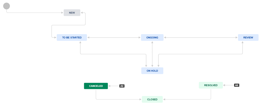

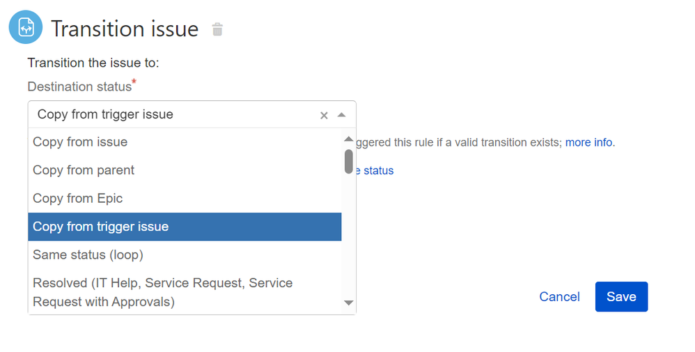

I'm trying to create a rule that can change the Service Request Status based on a set criteria. When the status is Canceled or Resolved, wait 7 days and then transition to Closed, as per the below Workflow.
I can filter out the results using a JQL query and only return the ones I want, below is the example I'm trying to change using the transition action.

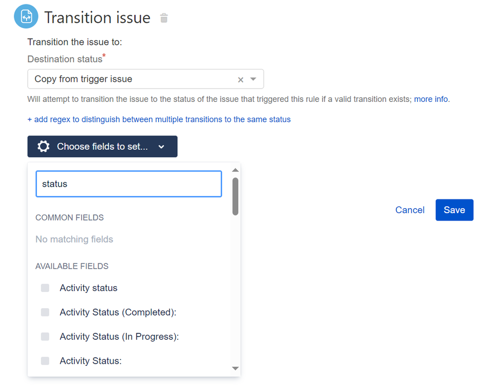

It is from here I get stuck trying to change the status to Closed, any advise on is this the correct action to be using, and how to find the status as it isnt showing a field just as Status. Is the "Copy from trigger issue" correct, and where to find the status field to change?

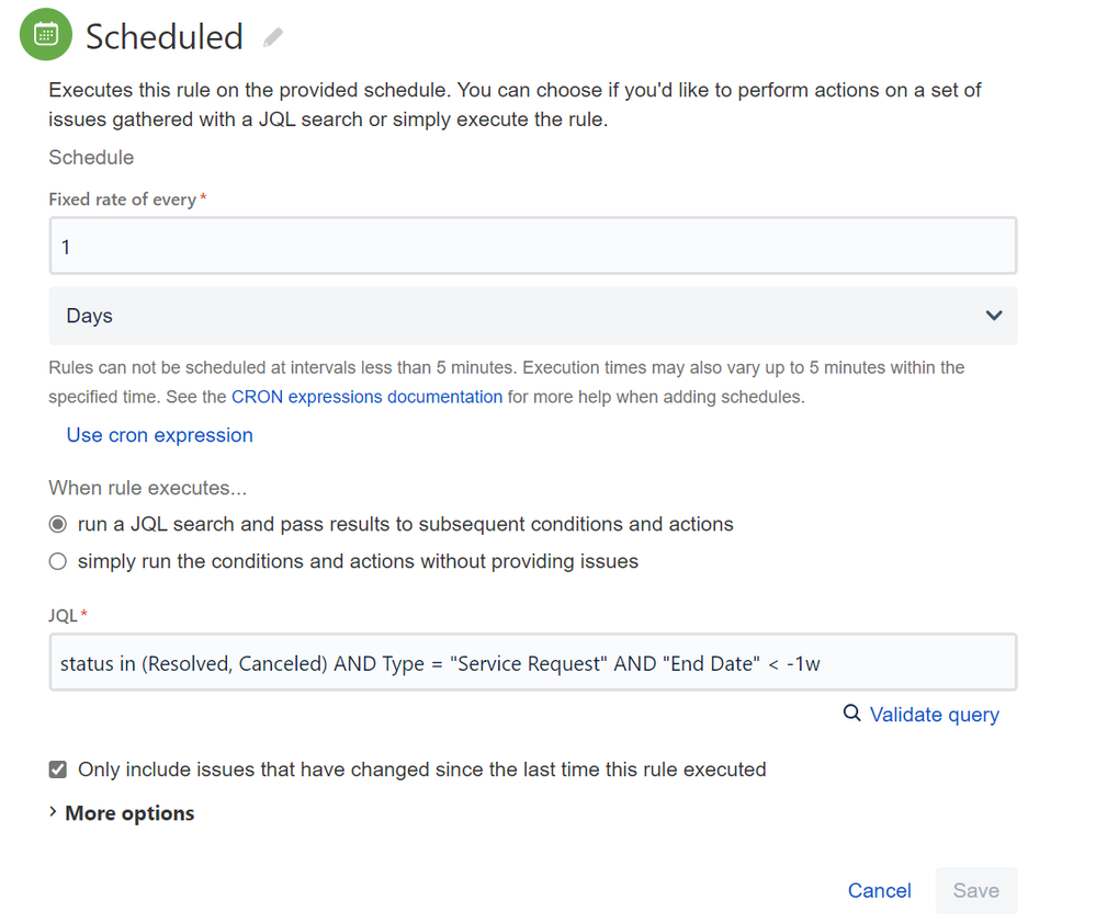

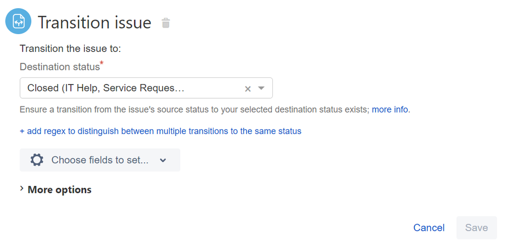

Thanks for the suggestions and assistance, I was able to greatly improve the efficiency of the scheduled task by your advice and figured out the solution to move the issues to the required status via the below screenshots. In addition rather than using the last updated field, we created an End Date field when it reached the final status and use this when looking to auto close.

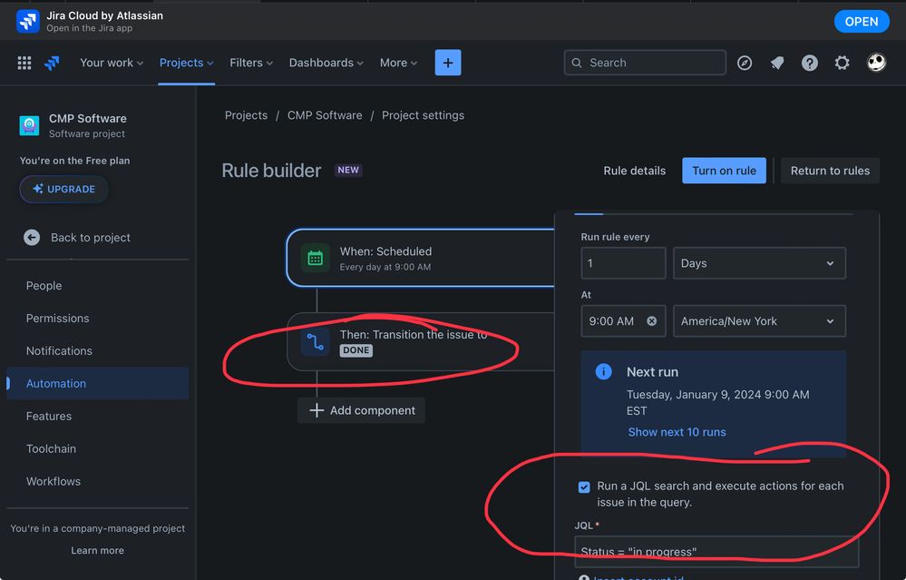

A question for you, why are you declaring the issue (AG-264) in your JQL? I think the solution is much simpler than presented unless I am missing something. Below is an example. I use the Scheduled daily trigger and the key is to tick the box "Run a JQL search and...". Then your JQL, I think, would be - status in (resolved, cancelled) and type = service request and updated < startOfDay(-7)

I'm selecting AG-264 just for my testing phase to see how i can change the workflow status. When deployed this condition will be removed and the updated < startOfDay(-7) will be added in.

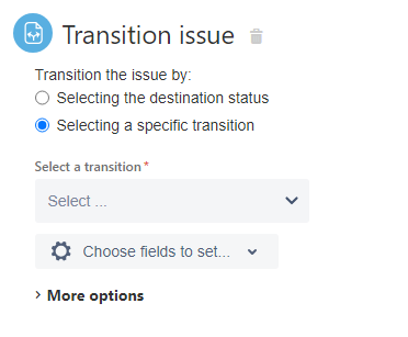

For the Transition Issue action you would select the option for Selecting a specific transition

My transition issue action doesnt have the option to change from destination status to specific transition.
