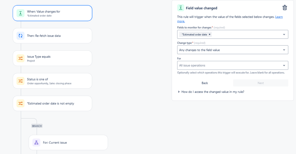

As a rule trigger I used my custom field “estimated order date”, if a change occurs here (create, update, etc.), the rule is triggered.

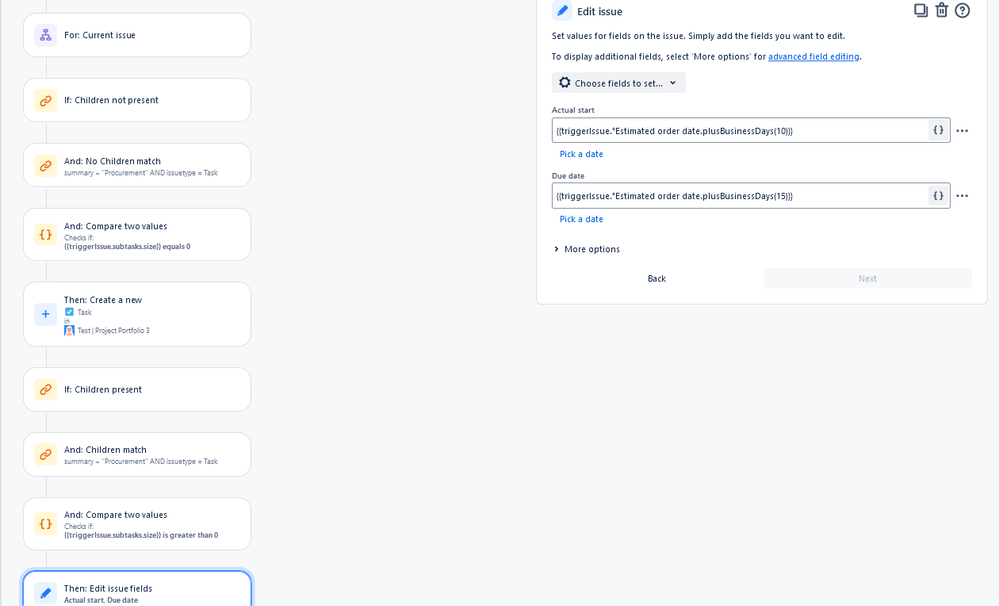

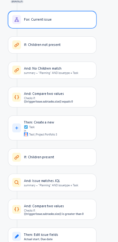

Then I try to either create the task using branching or update the task with new date if available. Apparently it is not possible to use the if/else block within a branch - I would find that very useful here. But hence the current attempt at a solution.
As for the update part, if the child already exists, only the start date and due date fields of that child should be updated. Here I currently use this smart value variant:
{{triggerIssue.°Estimated order date.plusBusinessDays(number of days required)}}
