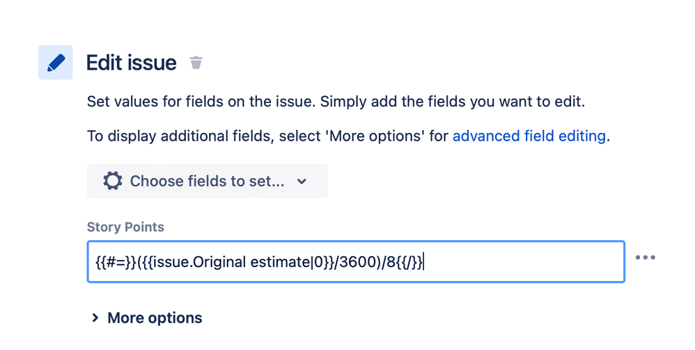

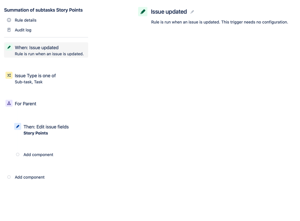

I am running a rule to update the story points of parent task when the sub task time estimations are update.
Rules are running successfully in the audit, but the story points are not updated in the parent task.

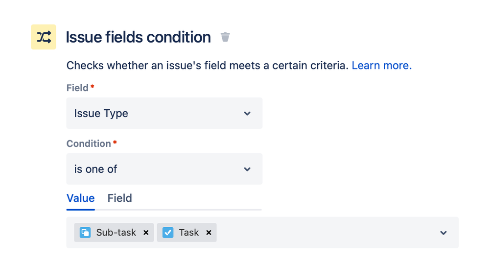

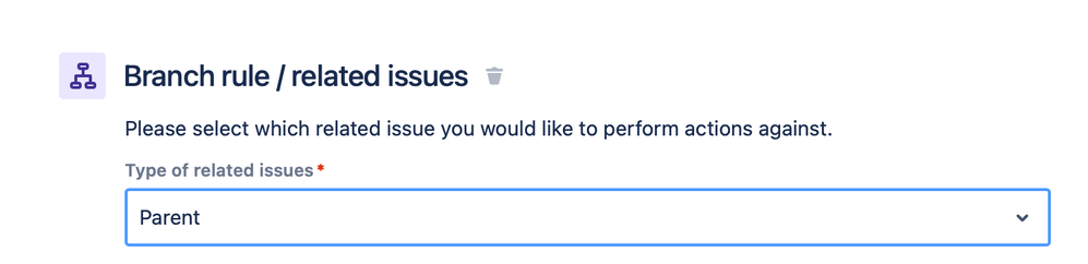

Hi @Gayan Kalinga and welcome to the community,
Please take a look at this rule from automation playground https://www.atlassian.com/software/jira/automation-template-library/rules#/rule/1381500/26460304
And keep in mind that branching for Parent will NOT add estimations to the Epic. Epic is not a parent of standard issue types.

Also I have tried the same thing as per the above link and still it is not updating the parent values.
Try the example I gave you (exactly as it is) and provide a screenshot of your audit log.

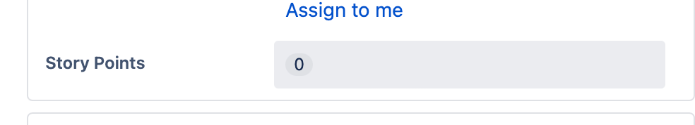

Created the rules as it is & publish all the changes

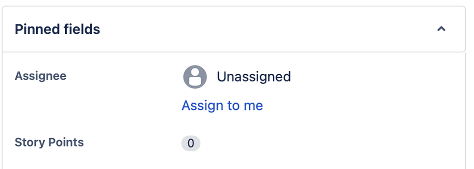

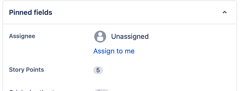

Create new story & create new sub task
Add story points 5 to sub task
check the parent story
but the result is same

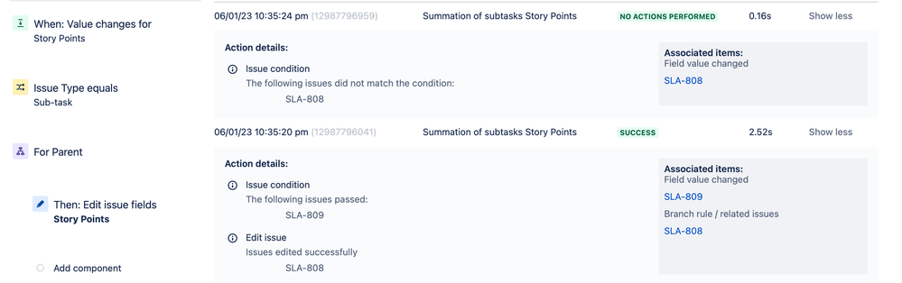

@Gayan Kalinga from the audit log I see that the issue did NOT met the specified condition. So there are two possibilities:
And if you keep pasting cropped images, I can't make out which image belongs to which issue. What are issues 808 and 809? What values do they have?
last one is because i tried to edit the parent so 808 is the parent. but before that one is when i edited the sub task
