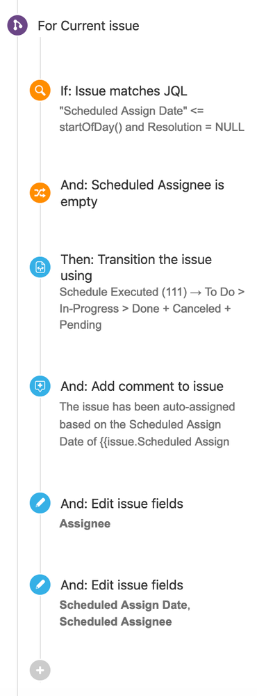

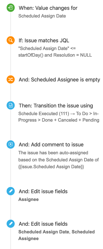

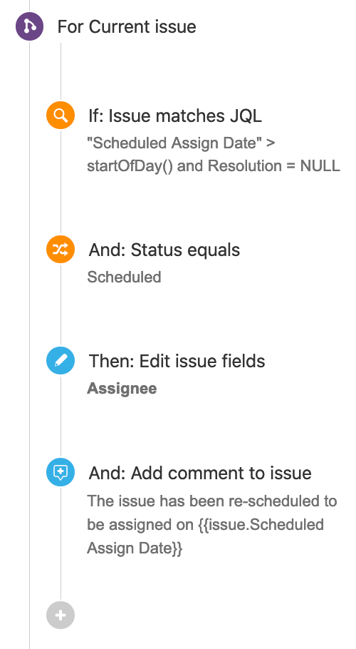

Hi,
I have setup up Jira Automation to perform some changes on issues when I schedule them to be assigned on a certain date.
I've created the below rules for (create and edit issue).
The rule performs all the tasks correctly, but it takes anywhere from 45s to 1m to complete.
It is a little long and I was wondering if you guys had any ideas on how I could optimize this rule?
I tried merging the JQL with the Stats condition into one JQL, but that didn't help at all. I really don't know what else I could change to make this rule execution time faster.
I would appreciate any suggestions :)

I am wondering if the outer JQL branches and repeated duplicate JQL conditions are the largest time sinks.
You could try substituting with a single, common condition test earlier and then use If/Else Condition for the variation parts, inverting the branches to simulate nested if/else last.  That would defer what appear to be the most expensive operations: branching.  Here is the information from Code Barrel (now part of Atlassian) on that idea: How to Optimize Your Automation Rules...
  • Trigger: value changes for Scheduled Assign Date
  • Condition: if resolution is Null
  • Condition (if/else): if Scheduled Assign Date > startofday()
    • Branch: JQL status not in Scheduled
      • Action: transition to scheduled
      • Action: edit assignee
      • Action: add comment
    • Branch: JQL status... and so forth
  • Condition: else if Scheduled Assign Date <= startofday()
    • and so on
With asychronous rule processing, logging time at certain points may not tell you much.  So you may need to clone your rules to test versions.  (Unfortunately, there is no version control of rules to revert to an earlier version.)
Maybe also check the rules performance insights (under the ... in the rules list) to see if any throttling is happening.
Best regards,
Bill
