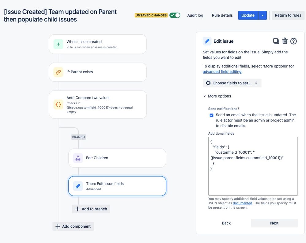

Automation Intended Outcome: When an issue is created or updated, automatically populate the "Team" field on all child tickets when the "Team" field is filled out on the parent ticket.

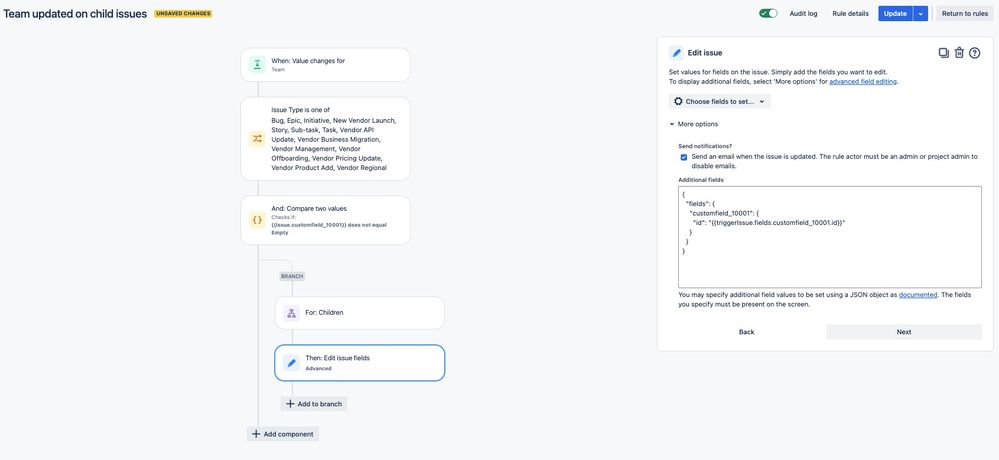

I have created two separate automations:
1st automation - for when an issue is created
2nd automation - for when an issue is updated
Neither automation is firing right now, so I'm curious what I am doing wrong. Any help is greatly appreciated!

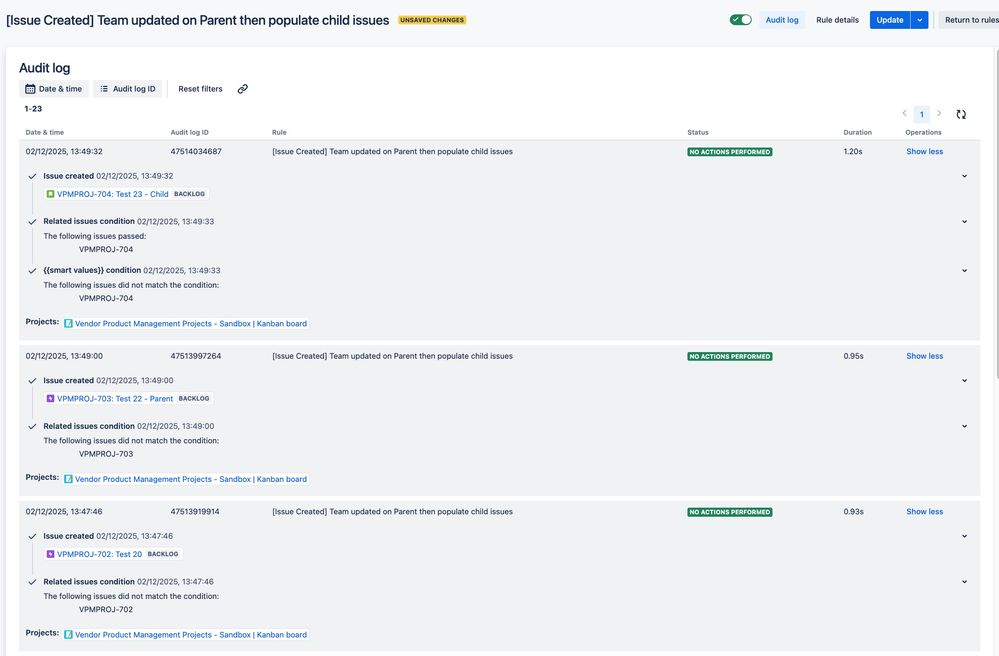

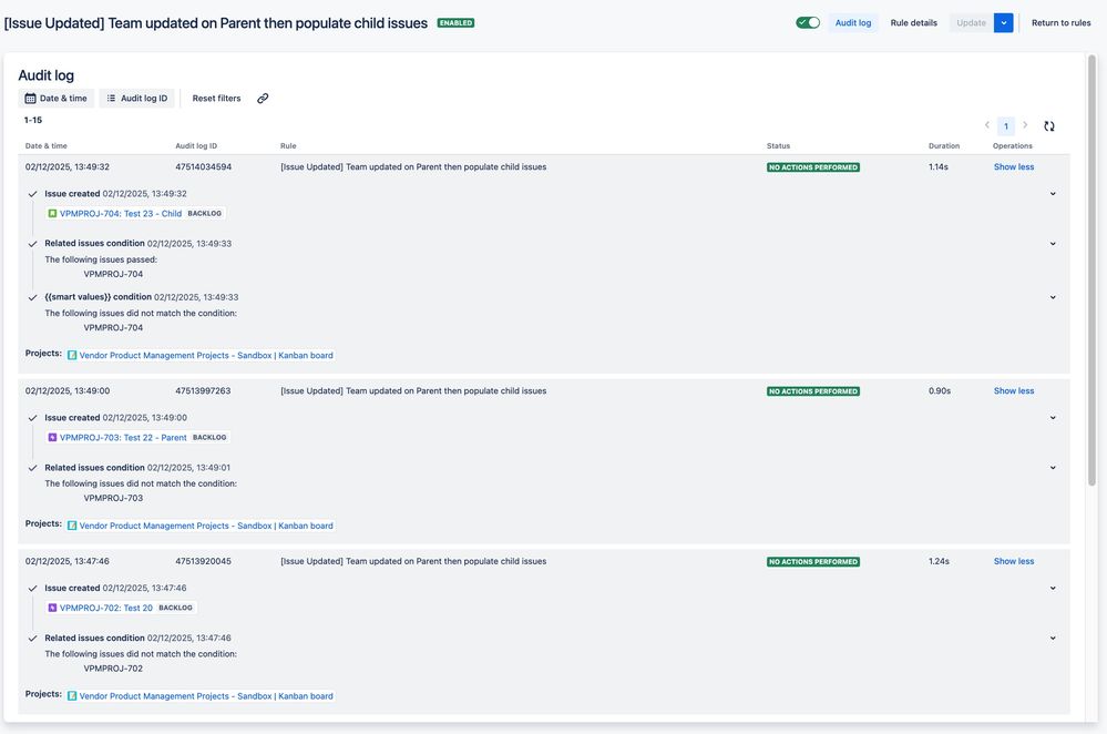

Thanks for getting back to me! Here are the expanded audit logs for both automations:
Issue Created Automation

Thanks for those images, and let's focus on one rule at a time, starting with the Issue Created one.
First, when using the Issue Created trigger, always add the Re-fetch Issue action immediately after the trigger.  The reason is that trigger can fire so quickly that some of the issue data may not be available to the rule yet...causing problems later.  The re-fetch will slow the rule a bit and reload the data before proceeding.
Next, please remove that Parent condition I noted earlier.
Looking at the log, VPMPROJ-704 did not have a value for the field, causing the condition to fail.  Does that sound correct?  If not, it may have been caused by the missing Re-fetch action I noted earlier.
Please make those changes, and then re-test your "created" rule.
Also please note: both of your rules have the same trigger, Issue Created.  Did you want the "updated" one to instead use the Issue Fields Updated trigger for the Teams field?

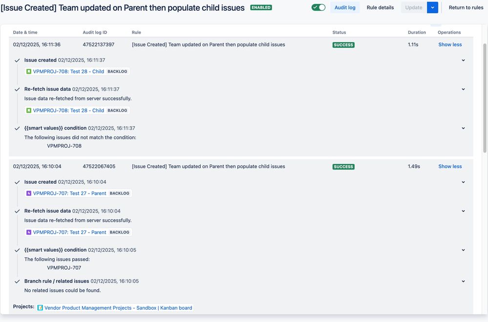

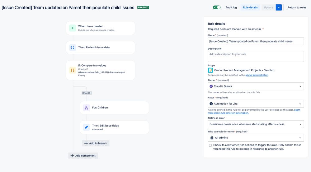

Focusing on the issue created rule, I removed the parent condition and added the Re-fetch issue action. This is how it is now set up. 1.jpg
Bill Sheboy
February 12, 2025
Thanks for those updates and additional testing.  That shows when the Story was created, it did not have a Team value, and...when the Epic was created, it did not have any children yet (which makes sense).

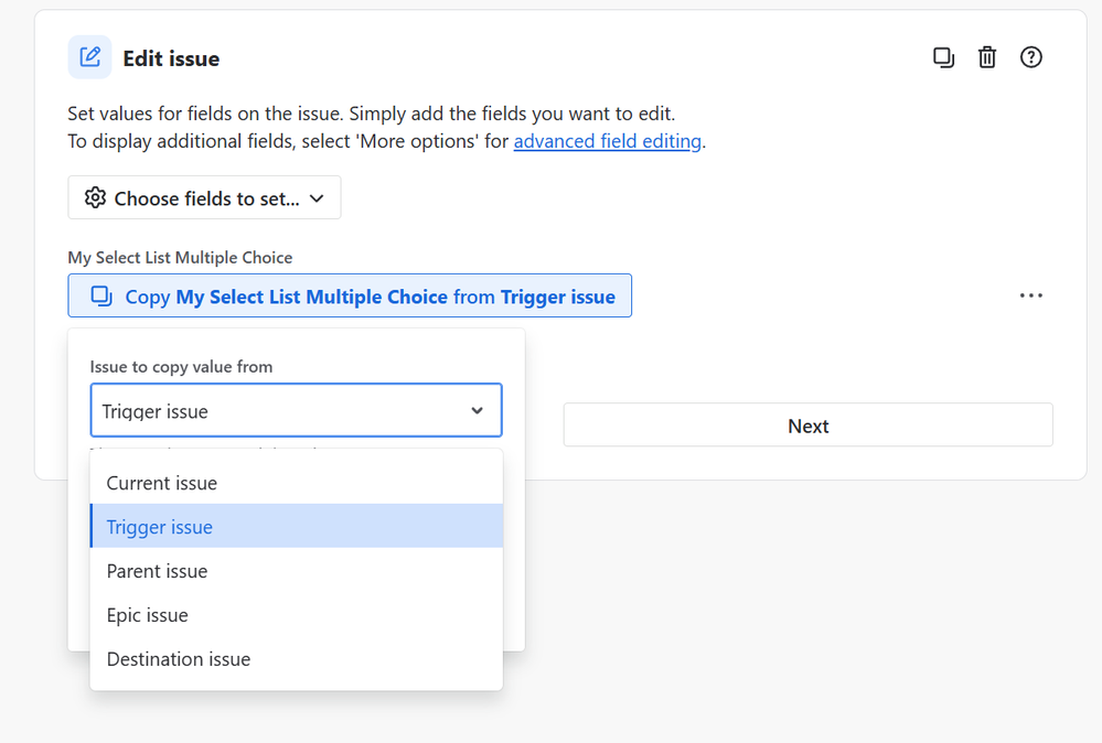

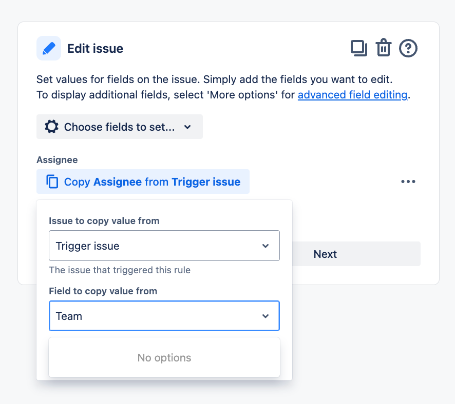

Thank you for this--however these are the only options I am given for the "Edit Issue" action. I don't see anything where it says to "Copy from Trigger Issue". Could you send me a screenshot of what it should look like for me on my end?
Bill Sheboy
February 21, 2025
Please select your field from the dropdown list, Choose fields to set.
At the right side of the field, there will be a ... option, select that, and then COPY.
Now click on the field, changing the source, Issue to copy value from, to Trigger issue
For example:
Claudia
February 21, 2025
This is great, however I cannot select my Team field. It only allows me to use the advanced field editing for my field.
Bill Sheboy
February 21, 2025
Thanks for confirming that as it shows JSON will be needed instead: https://support.atlassian.com/cloud-automation/docs/advanced-field-editing-using-json/#Single-select-custom-field

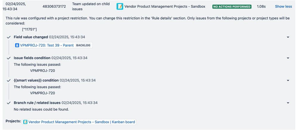

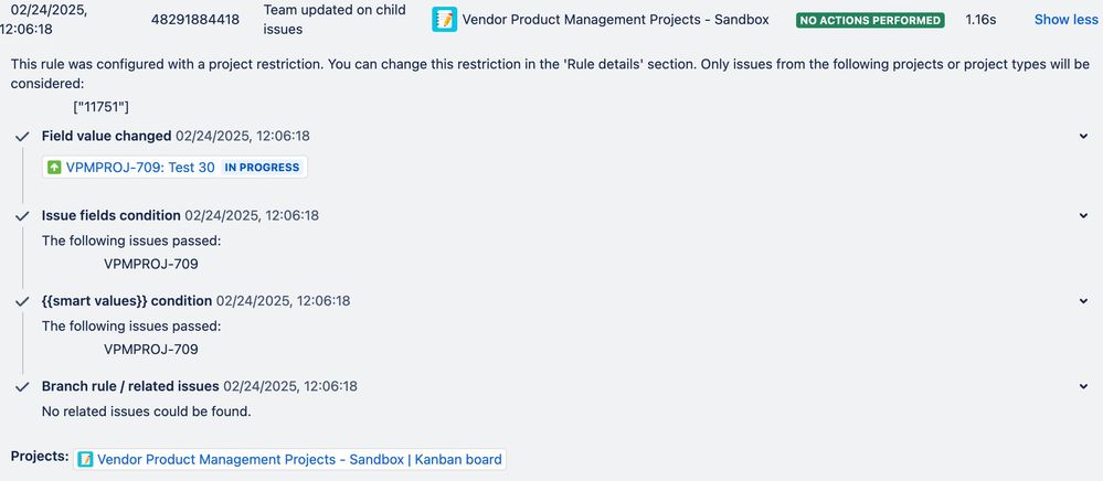

I added in the JSON to define the "Team" field using advanced field configurations you sent me, but it is still not working. The "Team" field in our instance is a "Team Picker (single team)" field type. The automation doesn't seem to be recognizing that a value is getting added to the "Team" field.
This was what was happening when I used your JSON:
"fields": {
"customfield_12345" : {
"id": "{{triggerIssue.customfield_12345.value.id}}"
I was instructed to change the JSON to this, but it is still not working.
"fields": {
"customfield_10001": {
"id": "{{triggerIssue.fields.customfield_10001.id}}"
Both say "No related issues could be found". Any thoughts here?
Bill Sheboy
February 24, 2025
I recommend focusing on the branch in the audit log.  That shows no issues where found, and so based on the earlier rule you showed that means there was no child issue.
Would you please show your current, complete rule?
