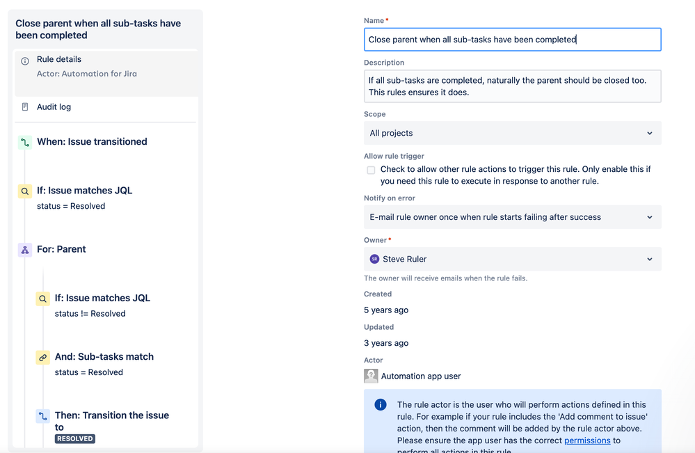

For inspiration, have a look at this sample rule from the template library (direct link to the rule ):
That should give you a fairly decent framework to get going. Update the conditions in this sample rule to match your situation.
Since adding an if ... else ... block can't be added under a branch (the for parent part in the rule) you may need to set up 2 separate rules for your 2 scenarios.
Hope this helps!

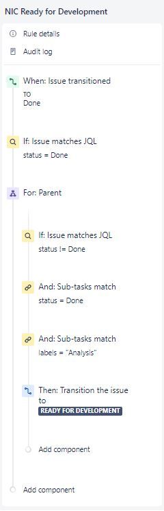

Yes, in fact I found this template that you suggest me and I am using it, but I am having a lot of problems with the condition If all sub-tasks with label = "Analysis" are with status = "Done". I am not able to solve it! :(
I have it like this way:

I think I can see the problem, but not a solution in your current approach. I suppose you use the "if all sub-tasks match ..." option to check your conditions. But since you have sub-tasks labelled analysis and other sub-tasks labelled development, you will never be able to make that work (there will always be sub-tasks that make the if all sub-tasks match "labels = analysis" fail.
I obviously don't know what your process looks like, but maybe you should take a step back and look at the way you've set up your process as a whole. If you build analysis and development as statuses/stages into the workflow of your parent issues, you may be able to get rid of the additional check you currently try to embed in your sub-tasks using labels.
In short: if your parent issues have a workflow like this: Backlog > In analysis > Ready for Dev > In development > Ready for Review > In Review > Done (just a high level example), you could just check if all sub-tasks are done when your parent is in analysis and move your parent to Ready for Dev. It would let you eliminate the additional check on sub-task labels that is now blocking your conditions.

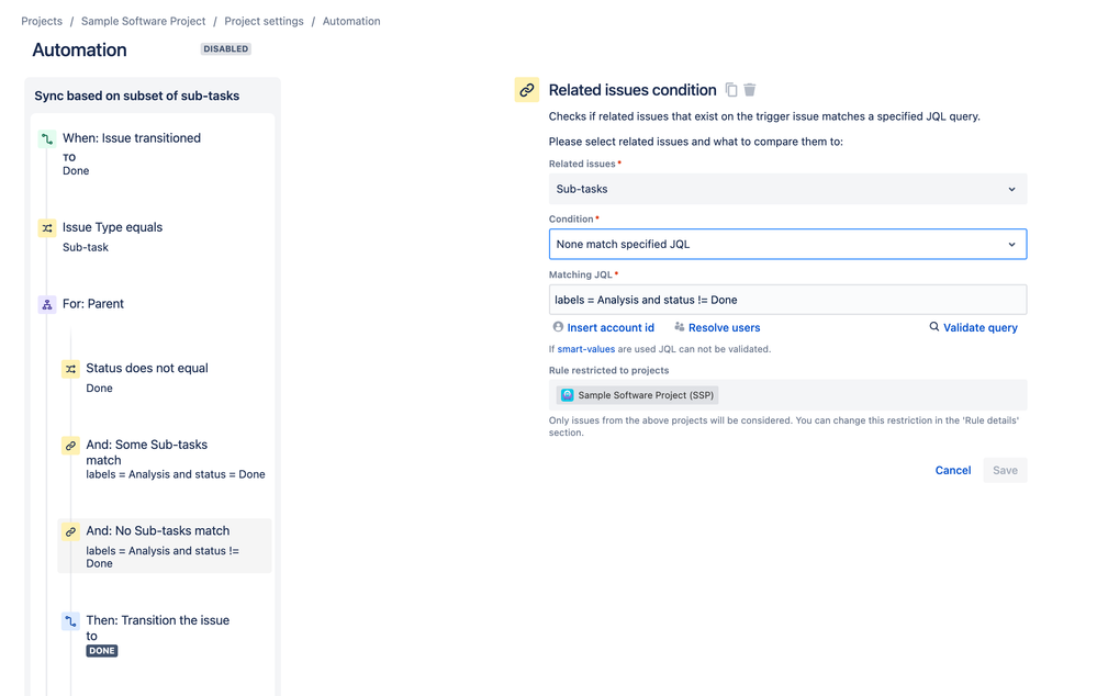

You may try something like this to isolate the analysis sub-tasks done codition:
Like Oscar Calvo likes this
Oscar Calvo
July 19, 2023
Yes @Walter Buggenhout !! It worked!!! Thank you soooo much!! :D
