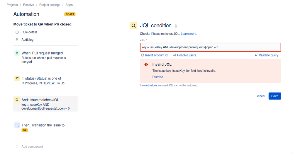

We are looking to automate the move of a ticket to a certain board column when all PRs have status closed.
I added this `development[pullrequests].open = 0` as JQL condition but it's not working 100% and I'm starting to think that need to add another condition to the JQL to match the current issue but couldn't find a way to compare the issue key.
The audit says:
JQL condition
The following issues did not match the condition:
John Funk
September 15, 2020
Hi Conrado - Welcome to the Atlassian Community!
Why do you have a check on the issue key? It is already only dealing with a single key. I would take that part out and see if it works for you.

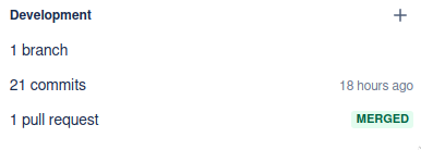

I have one issue with a single PR merged
But when search for:
issuekey = <ISSUE_KEY> AND development[pullrequests].open < 0
I get that No issues were found to match your search

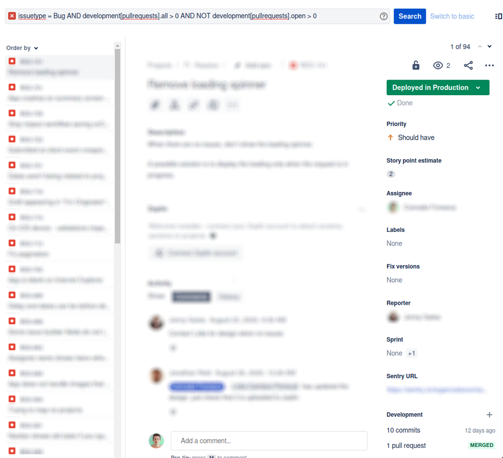

Just found that this condition works only for issue type Bug, I'm able to get the proper results with:
issuetype = Bug AND development[pullrequests].all > 0 AND NOT development[pullrequests].open > 0
but not with any other issuetype value, think that is the reason the JQL is failing in the automation.
Removing the issue type, it just returns Bugs, there are any other kind of issue type being listed.

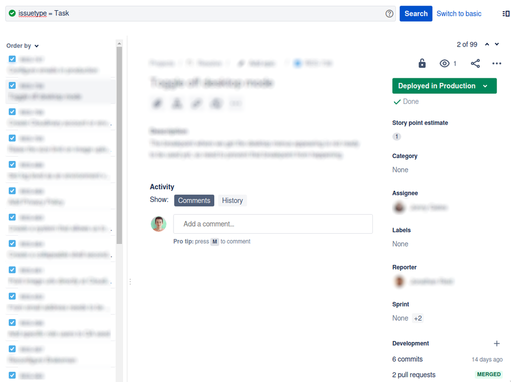

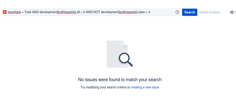

Task is another issue type. Going to attach some images to add more context to the issue.
Filter all Tasks without PR condition, it's possible to see that the selected issue have a PR merged.
Filter all Tasks with PR condition, no issues listed
