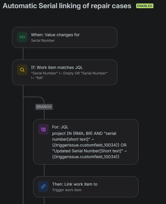

Here is one of our current automations for our repairs project. Currently when a work item is created it requires the serial number of the returning item. This links any other work items matching the serial number field so we can see how many times it has been in before and for what reasons. Our returned items are never in more than 4 times before being decommissioned. However, if one of our repairs has had a memory issue then we have to reserialise it which the new serial number would go in to the "Updated Serial Number" field. So if that item comes back in again it will only bring up the last time it was returned for repair. I would like for it to also see that what it has linked to also has previous links, and link those to the latest work item.

First, your rule appears to access work items in multiple projects.  Thus, the rule scope must be global or multiple-project to access those.  This can be done by a Product Admin in the global automation area.
Next, for the rule you show there are a few things to improve:
  • Smart values are name, spacing, and case-sensitive.  The one for the trigger issue is: {{triggerIssue}}
  • When comparing the short text, custom fields in JQL, wrap the values in quotation marks
  • The JQL is missing parenthesis around the the tests on the serial numbers.  As written, that will potentially match work items in other projects.
  • You probably do not want to add links when they already exist, so add a clause to the JQL to exclude them with the linkedIssues() function
Putting those together, please try this:
project IN (RMA, BR)
AND (
"serial number[short text]" ~ "{{triggerIssue.customfield_10034}}"
OR "Updated Serial Number[Short text]" ~ "{{triggerIssue.customfield_10034}}"
AND issue NOT IN linkedIssues("{{triggerIssue.key}}")
ORDER BY Key ASC
I recommend testing that with an example work item in an search outside the rule to confirm it works as you expect.

The above rule works already, not looking to change that, tough I do appreciate the improvements and they do seem to work. I would however like to either expand it so that when it has linked to an item, it finds that works item's links and also links them.
