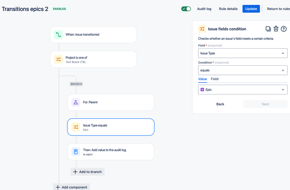

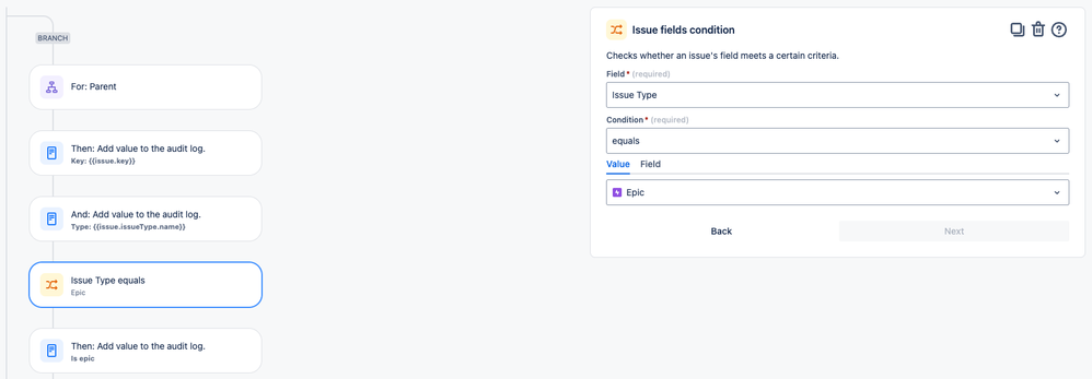

I have a trigger "When: issue transitioned".
I want to check if the parent is an epic, and if so continue with my flow.
This is what that part of my branch looks like:

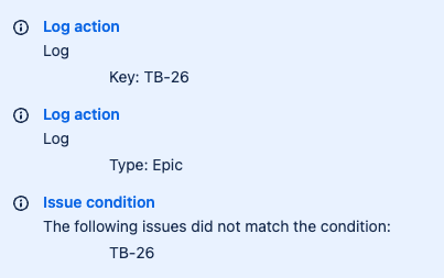

But when the rule gets triggered by a child with an epic, the step fails, even though in the logs I can see the issue type is an epic.
The log "Is epic' does not show up.
What am I doing wrong here?

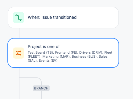

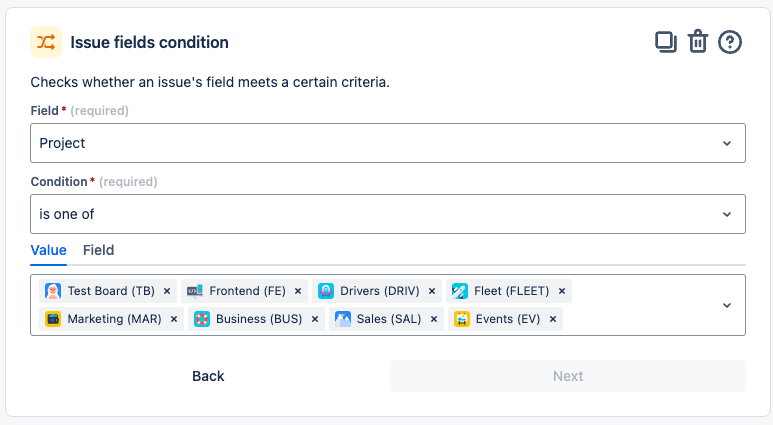

There are multiple projects, they are all "Company-managed software".
The rule was new.
I tried deleting and creating a new "Issue Type equals" step, but this had no effect.
Kind regards

What do you have in the Rule Details page for project scope?
Glenn Ruysschaert
June 28, 2024
Hello @Trudy Claspill ,

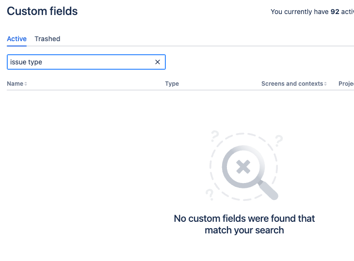

Can you confirm that you don't have a second field named "Issue Type"? Jira does not require that custom fields have unique names. It is possible that somebody has created a custom field that reused the "Issue Type" name.
Trudy Claspill
July 1, 2024
Hello @Glenn Ruysschaert
You said you checked the issue types. I was not asking you to check the issue types. I was asking you to check the Custom Fields to find out if there is a custom field named "Issue Type".
https://<yourURL>/secure/admin/ViewCustomFields.jspa
There should not be a field on that page named "Issue Type". If there is, that is the root of your problem.
You can also try using a Smart Value condition rather than an Issue Field condition, and comparing the {{issue.type.name}} to "Epic", as a workaround.
Glenn Ruysschaert
July 1, 2024
@Trudy Claspill
Ah, my bad, I misread what you said.
There is no custom field with that name.

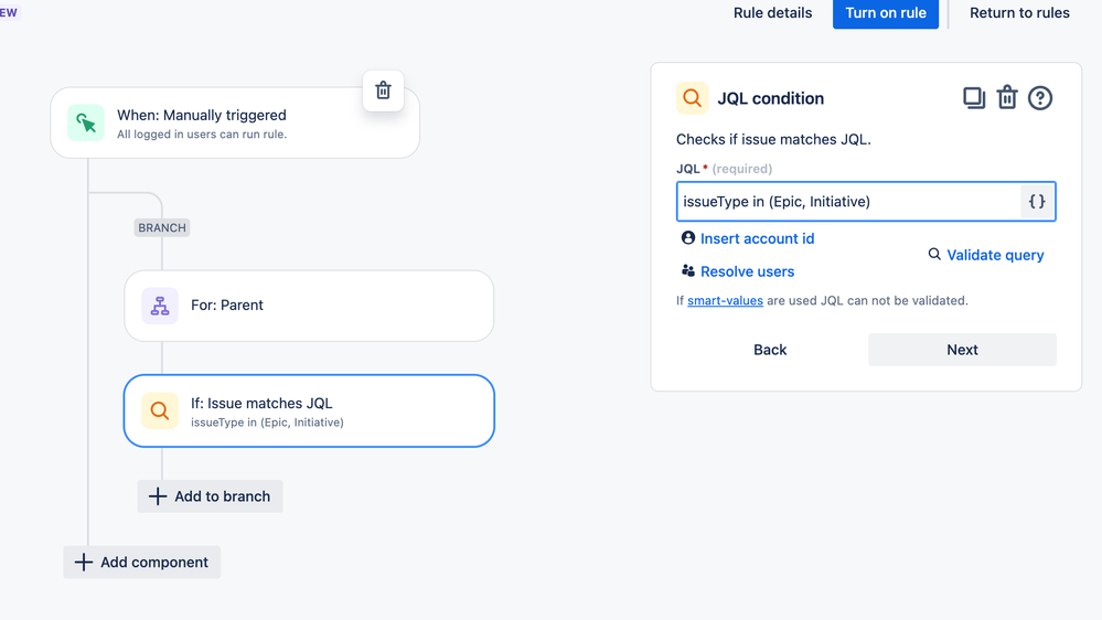

However, the original automation is not only for Epics but also Initiatives.
That's why I used the Issue Type, because you can say "one of" (Epic or Initiative).
With Smart Values, I don't know how to do an "or".
Unless I duplicate the branches (for epic and initiative), which is less great for maintenance.
Trudy Claspill
July 1, 2024
You could try a JQL condition (ignore the Trigger in my example)
Glenn Ruysschaert
July 1, 2024
@Trudy Claspill
Yes, that worked!
It works in the simplified automation and the full automation, when I replace the built in "Issue Type" check with your JQL condition.
Thank you very much!

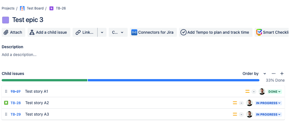

I checked the issue types, there is only one of each.
I recreated a very basic setup (this time with only one target project), and it still does not work.

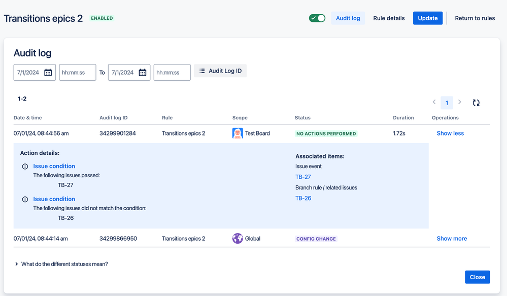

The epic and story I am testing with is this, I am changing any of the story statuses:
This is the basic setup:
And the result from the audit log:
Do you spot something I did wrong?
