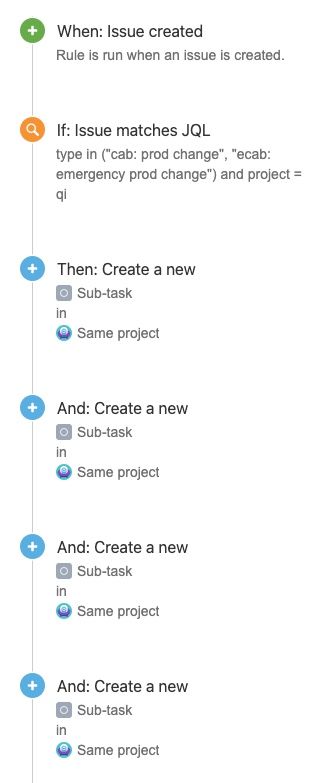

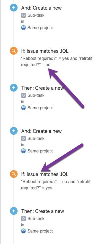

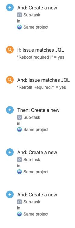

I have automation setup to create five sub-tasks and then an "IF" statement to create four addition sub-tasks depending on the answer. This is working as intended, however, if I add another "IF" statement after the first one, it appears to be completely ignored. The first "IF/AND" validates and works as intended, but anything after that is ignored. Do I need to make a new trigger for this or something? Basically, if one or the other or both are "Yes" I need specific sub-tasks created.

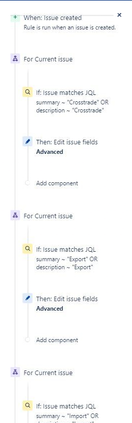

I would recommend using branches in this case, to ensure that the automation is going through the If statements.
So, if you embed each separate If statement in a Branch, they will all be validated separately. Here's what you can do:
Please give it a try and let me know how it goes.

Thanks! That worked.
