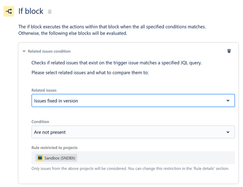

Now creating the Automation rule, I use an If-Else-Block and check if all issues in this fix version are matching a JQL checking their state:

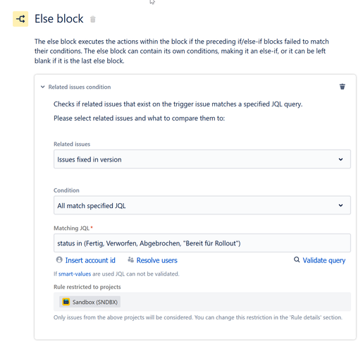

In the screenshot this is a Else-Block because I tried to catch the following error but without success, so it doesn't matter at this point:

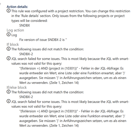

As you can see the correct issue (SNDBX-2) is triggering this rule. But at this point the fixVersion is empty. Let's say I put a wrong command into the audit log step.
Then the next thing happening is the build-in check for the version which fails as well.
(The error message just explains that there was a value expected but a ) found)

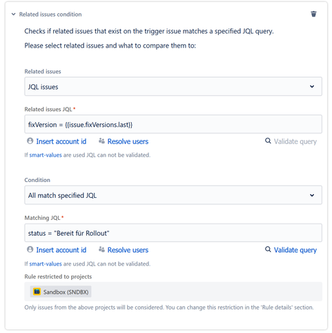

I needed to create a JQL doing a similar check:
