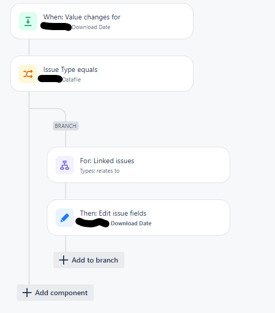

I created a rule 3-4 months ago that worked great - automatically updating the same (custom) "Download Date" field type when that field was updated in a (renamed Datafile) Bug or Story type issue for all task type issues linked as "relates to" to the Datafile.
Last week the rule started failing and the only notes are below which is not accurate:
I have checked that the issue types all do contain this field type and tried turning rule on and off, copying it, and also asking Atlassian AI to write a similar rule (came up with the same old rule) here it is: (redacted)
screenshot 2 jira.pngAny thoughts or help appreciated!

thanks Trudy, the rule is limited to linked issues in the particular project, I did create the field and don't think it's used in other projects but will check, if it was copied in other projects how would I update the rule so that it worked again?

Sarah Schindler-Williams
July 12, 2024
Thanks Trudy, I actually created this field within the Team Project, it was only ever used by this project (to my knowledge and based on current context screen) and the rule worked great up until about a week or two ago.
The edit issue step is set to copy the value of the Download Date field from the trigger issue (the Datafile type).

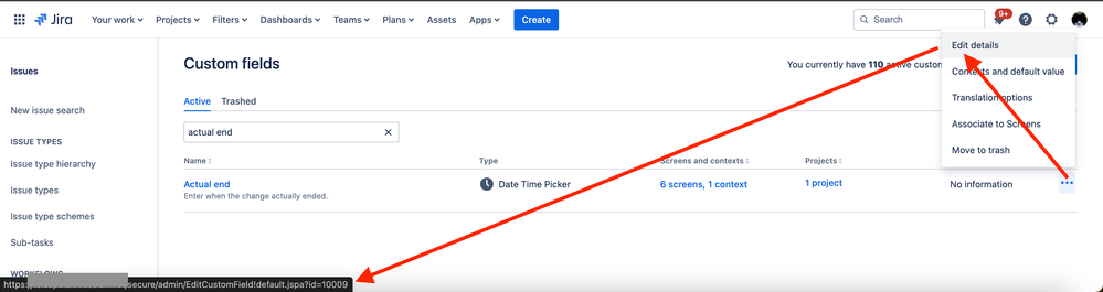

Trudy Claspill
July 12, 2024
Is it true that you see a field of the same name in the Custom Fields screen available at ...?
https://yourURL/secure/admin/ViewCustomFields.jspa
If so, can you click on the ... next to that field and hover over one of the options. At the bottom of your browser you should see a link that includes the field's ID. Make note of that field ID.
You also said that you "created" the field within the Team Managed project. Within Team Managed projects you can create new fields that are specific to that one project, and you can reuse fields (that have a global context) that have been created in the Custom Fields page.
So, I think we need to confirm which field is actually being used within your Team Managed project.
Find an issue in the Team Managed project that has a value in that field. Use the information here to get the JSON output for all fields for that issue.
https://support.atlassian.com/cloud-automation/docs/find-the-smart-value-for-a-field/
Find the field in that JSON output. Check the ID number associated with it. Compare that ID number to the ID number you found for the same named field in the Custom Fields screen. Are they the same or different?
If they are different, then your automation rule is likely getting "confused" because it is not sure which field you are actually trying to reference because there is more than one field in the system with the same name.
In that case the Automation Rule needs to reference the field by its ID. In that case you would have to use the More Options section of the Edit Issue action, and edit the field using the Advanced Editing with JSON capabilities.
https://support.atlassian.com/cloud-automation/docs/advanced-field-editing-using-json/
