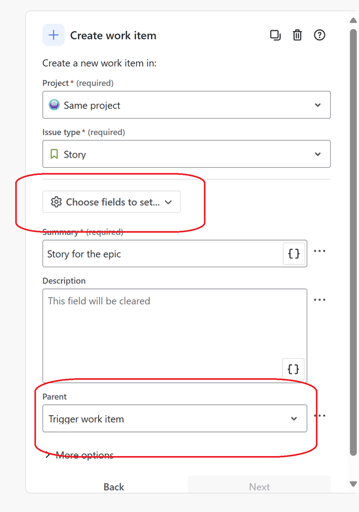

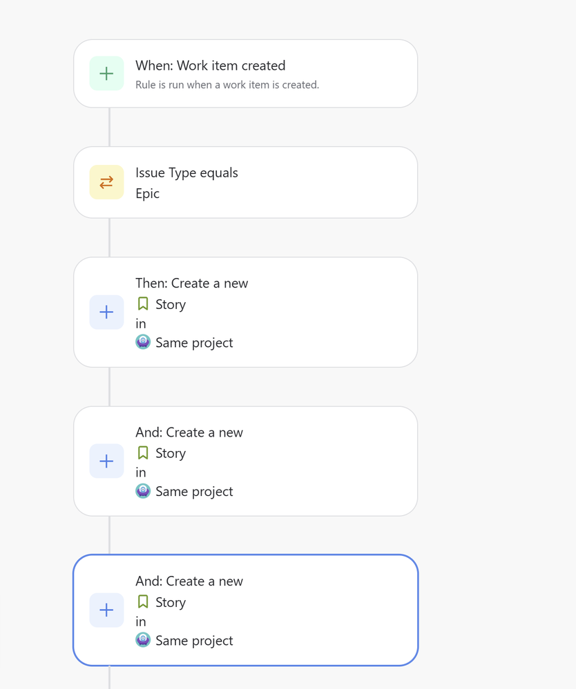

I've reviewed your use case, which I'm still confused with something, but I've done a test and I'm able to create an automation rule that can create multiple work items when an Epic is created.
In this example ,I have 3.
On each story, they are linked to the epic using the Parent field
Now, in your use case, you've mentioned that you need several stories. Sometimes, you need three, and other times, you may need more or fewer.
How are you deciding how many you need?

I've tried to copy what you mentioned, with just 1 story for now.
I cant paste a picture here to show what i did.
The first action "When: work item created" sounds like it will create an epic with substories every time i create an epic.
This is not what i want, i want it to be created on demand (Manually) in certain situations.
For me to manually activate this, i see only an option to run the automation from an existing Epic.
There is no visible way to have this rule activated outside of an existing
I am not able to get the "PARENT > trigger work item" to show.
I wish i could share a picture because there are some differences between the options i have.
