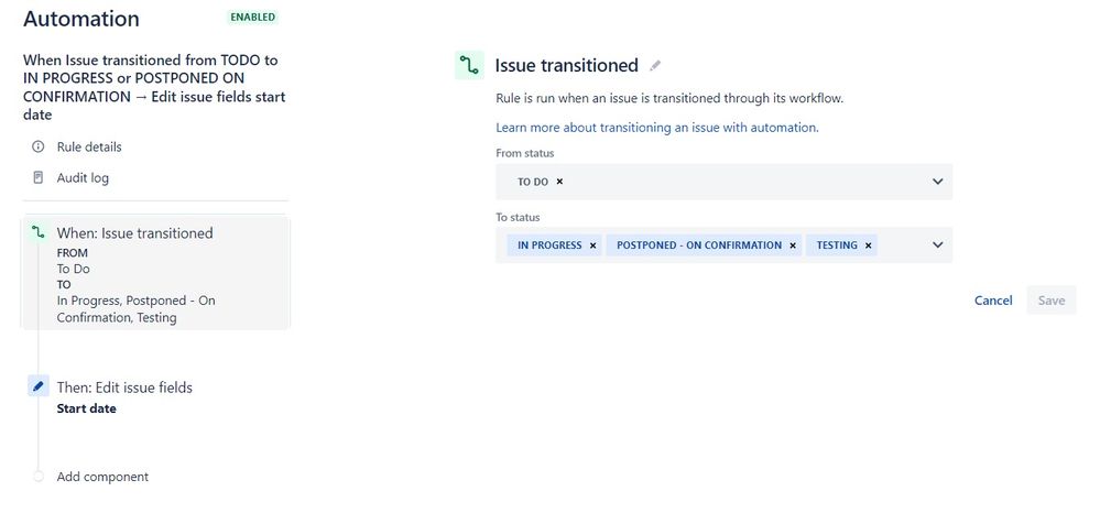

First Rule:
When Issue transitioned FROM To Do TO In Progress, Postponed - On Confirmation, Testing Then Edit issue field Start date.jpg

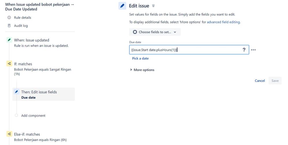

Second Rule: (in one trigger in this rule there are 6 conditions)
When Issue Updated If Bobot Pekerjaan  equals Sangat Ringan (1h) Then Edit issue fields Due date.jpg

@Rilwan Ahmed
The capture above is an automation rule that I have compiled.
Rilwan Ahmed
August 12, 2022
Hi @Erna Putri Utami ,
Sorry, I could not find a solution for your requirement.
What I observed is, you cannot update time for DueDate an StartDate fields. Only date can be selected.
Check if this  Workaround helps you:
  • New trigger: Issue transitioned
    Select from and To Statuses
  • New Action: Edit Issue --> Select Start Date and in text boa add "{{now}}".
    i.e. Start date will be updated to the date when ticket is transitioned.
  • Add component --> New Action --> Edit issue --> select Due Date and mention"{{now.plusDays(3)}}".
    i.e. Due date will be set to date when ticket is transitioned + 3 days.
This is how the rule looks
I have attached a ticket screenshot as an example where automation updated the start date and the due date
