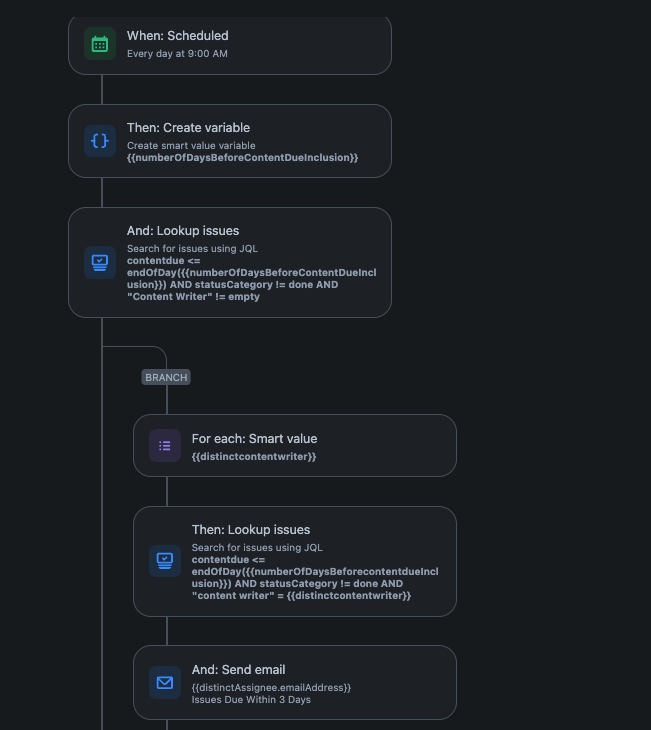

Massiel Estevez
February 22, 2024
Thanks, here is how's its currently setup but continue to flag as failed. Screenshot 2024-02-22 at 9.23.27 AM.png

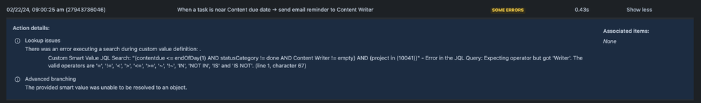

Massiel Estevez
February 22, 2024
With the following error message: Screenshot 2024-02-22 at 9.25.52 AM.png
Bill Sheboy
February 22, 2024
The error with the JQL statement is the field Content Writer should be in quotation marks.
I recommend writing and testing that JQL stand-alone first with an issue search.  Once the field names and syntax are correct it can be used in the rule.

Massiel Estevez
February 26, 2024
Bill Sheboy
February 26, 2024
Yes, if that is the correct field name.  Again, I recommend testing that JQL stand-alone first to confirm it works as expected.
