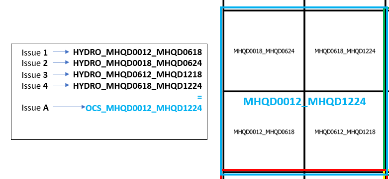

  • The issues A, B, 1, 2, 3, 4 are at the same hierachy level (In Issue type hierarchy settings). Please find below an example of how the issues are linked.
And so, I am looking for an "easy" way to set the links : Issue A is blocked by Issue 1, 2, 3, 4.
As you described in your message, we can do a 2nd CSV import in order to set the links between issues. But preparing the CSV files will time consuming. As example : OCS_MHQD0012_MHQD1244 and TRANS_MHQD0012_MHQD1244 will be blocked by these 8 issues:
  1. HYDRO_MHQD0012_MHQD0618
  2. HYDRO_MHQD0018_MHQD0624
  3. HYDRO_MHQD0612_MHQD1218
  4. HYDRO_MHQD0618_MHQD1224
  5. POP_MHQD0012_MHQD0618
  6. POP_MHQD0018_MHQD0624
  7. POP_MHQD0612_MHQD1218
  8. POP_MHQD0618_MHQD1224
I was hoping with Automation we can set these links. So maybe using a custom field in POP and Hydro issues where we record "MHQD0012_MHQD1244 ", then Automation will link all the 8 Hydro and Pop issues to the issues summary containing "MHQD0012_MHQD1244" .
I am certainly quite ambitious, that's why I need your suggestions :)
