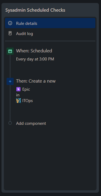

Here's what I have so far:

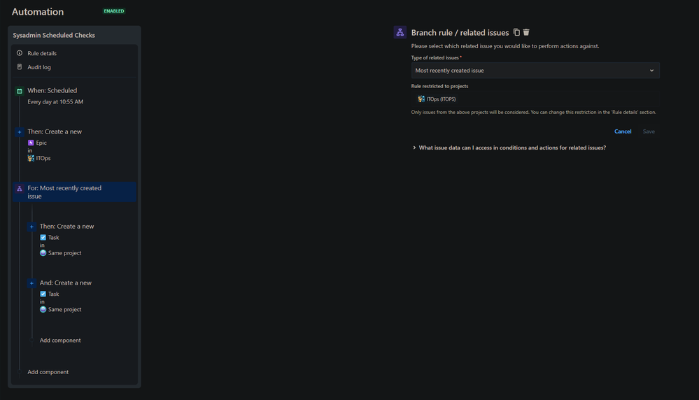

Click on add Component and select Branch
Then Basic branch
Then Most Recently Created Issue

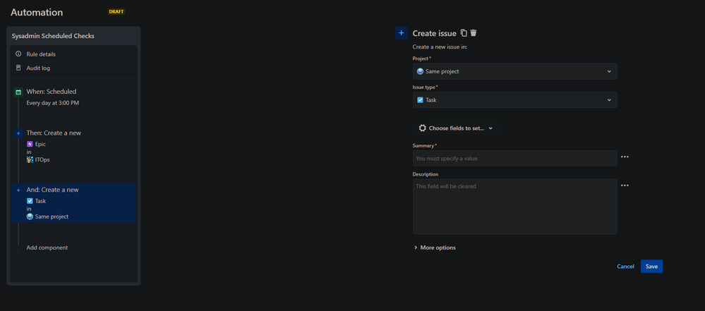

Thanks John that sounds like it might be getting closer. It still seems to just create the Epic and no issues though - do you know where the problem is?

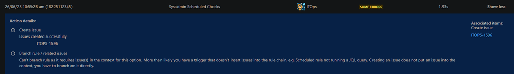

Here is the result, sounds like it's struggling to recognise the Epic creation?

FYI I have successfully created the Epic AND the Tasks however it does NOT link them together, they are all created separately. It seems like the "Most recently created issue" logic doesn't function how we want it - I guess the Epic we're making doesn't quality as an "Issue"?

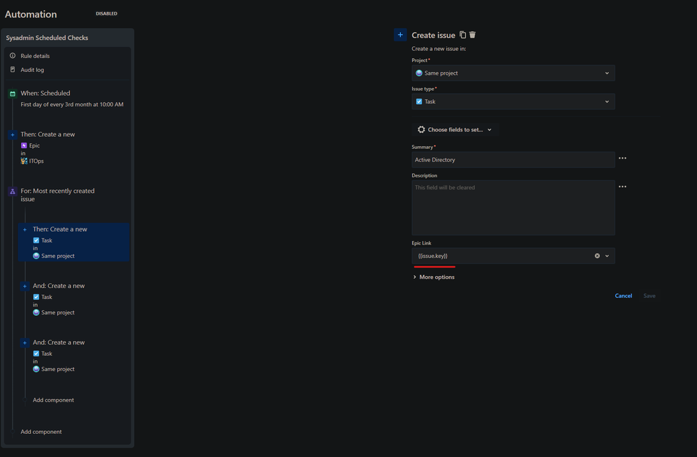

Now inside the branch when you create the tasks, what value are you putting/selecting for the Epic Link?  You can try typing in {{issue.key}} as that will refer to the branched-to issue: the epic just created.

Your earlier rule seems like it should work, with branch to most recently created issue, followed by creating the tasks and linking to current issue.  (I think I gave bad information earlier on what to use, which I will correct in the earlier post.)  How about this one:
  • trigger: scheduled
  • action: create issue (for your epic)
  • branch: most recently created issue
    • action: create issue (for your task, and...)
      • For the Epic Link, type/copy in {{issue.key}}
      • This will appear below the field, and then you may select it for use
      • Inside of the branch, {{issue.key}} refers to the branch issue: your epic.
Like John Funk likes this

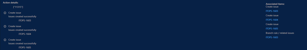

Thanks for your patience and support - we have success!

Sure! For the next poor soul who attempts this here is my final config. The key to the solution is the custom field inside the tasks linking it back to the Epic.
