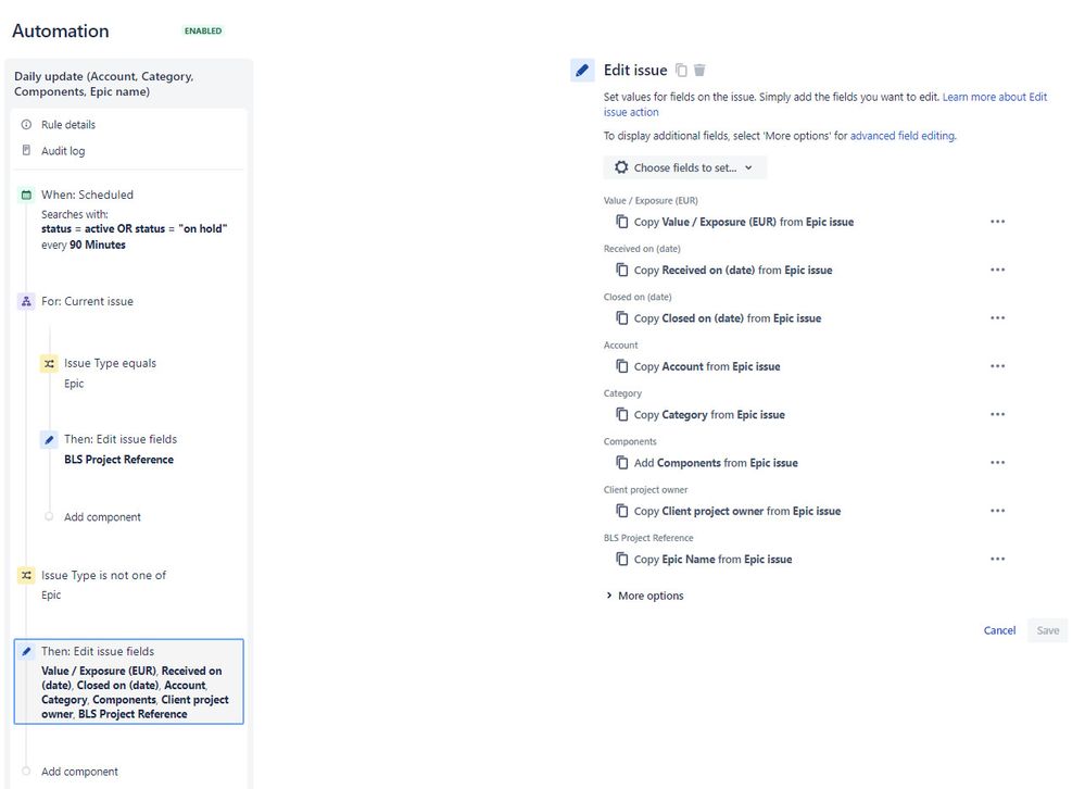

Hi @Bill Sheboy , thank you for your kindly answer.
My rule is the following:

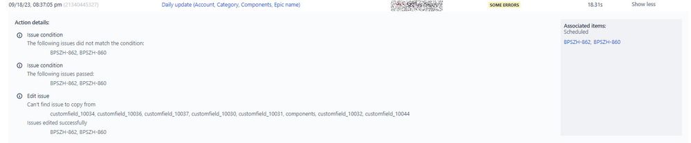

And the result:

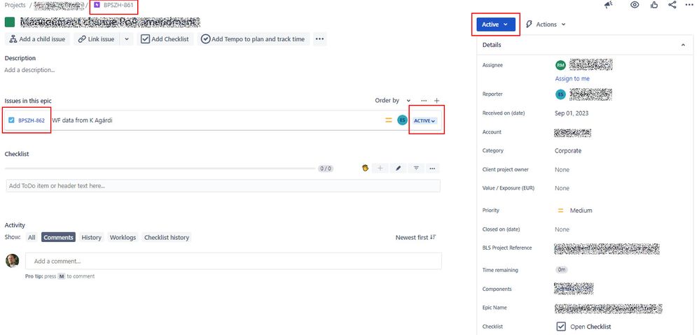

Both the issue and its epic are exists and in active state - that is why i can't understand the error result. For example:
Epic: BPSZH-861 > Issue(Task): BPSZH-862

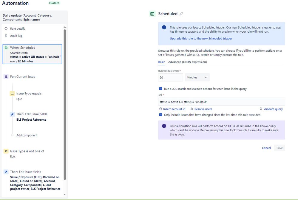

Thanks for that information.
The audit log also shows BPSZH-860 was picked up by the scheduled trigger: what type of issue is that?
I suspect is it not an epic and it does not have a parent epic, as that would cause the errors in the Edit Issue action.
If your intention is the second part of the rule only runs for issues which have an epic parent, you can enforce that by adding another condition test after the test "Issue Type is not one of: Epic".

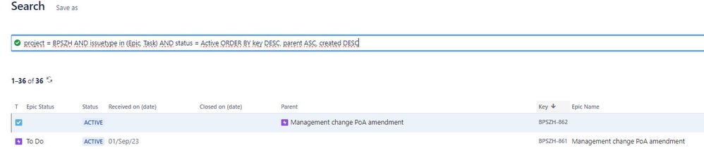

Also as an evidence i created a filter, that demonstrates that JIRA finds the issue and its epic also:
The Epic Name is the same the issues "Parent". I wonder is it possible to make a query based on unique IDs not names to be sure that the issue-epic connection is correct.

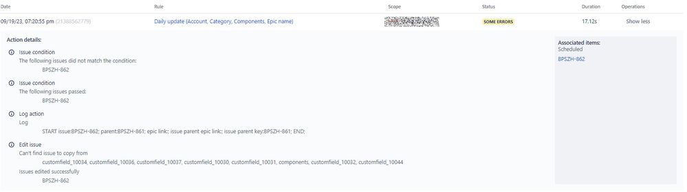

I confirm, i reproduced the same error on the same issue+epic.
I've tried with more log fields:
"START issue:{{issue.key}}; parent:{{issue.parent}}; epic link:{{issue.Epic link}}; issue parent epic link:{{issue.parent.Epic Link}}; issue parent key:{{issue.parent.key}}; END;"
The result the same:
