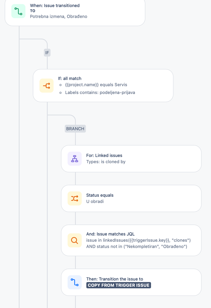

Luka Delić
October 26, 2024
Hi, I have tried countless edits to this rule, none of them work. I find the original issue  to which the triggering issue is linked, but i have trouble finding a way to check status of other clones of the original issue. Clones are linked to the original issue, but not linked with each other.

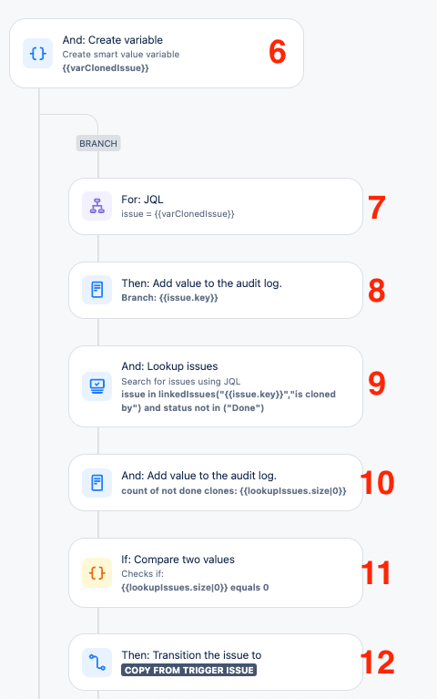

If so, then a rule like this will work for you:
  1. Rule is triggered when the status of B-1 is changed. I use "Done" as the status that indicates the issue is resolved.
  2. Check if the trigger issue is a Clone of another issue.
  3. If the trigger issue is a clone of another issue, use a Lookup Issue action to find that issue, also ensuring that it gets the issue only if the source issue is in the specified status. In your rule you have a later condition to make sure the source issue is in the status "u obradi".
  4. Check that the Lookup found exactly 1 issue. If the source issue is not in the specified status ("u obradi" in your case, "In Progress" in my example), then the Lookup will retrieve zero issues and the rule will stop processing.
  5. If the Lookup found exactly one issue, log the issue key of that issue in the rule execution log.

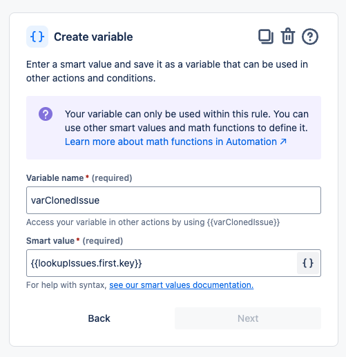

  6. Create a variable to store the issue key of the source issue (A-1). Here is the detail of the action.
  7. Branch to the specific issue found by the Lookup. Use a JQL branch instead of a Related/Linked Issues branch.
  8. This is logging the issue key of the issue to which we have branched to the rule execution audit log. This should be the source issue key again (A-1).
  9. Use a Lookup Issues action to check for any issues that are cloned from the source issue where those issues are in an unresolved status.
  10. Log to the rule execution log the number of issue found by the Lookup,
  11. Check that the Lookup found exactly 0 issues. If the Lookup finds any issues, that means an issue cloned from A-1 is in an unresolved status, and you want the rule to stop processing.
  12. The source issue (A-1) has no clones that are unresolved, and we previously confirmed that it is in the status we want (i.e. "u obradi"), so transition A-1 to the same status as the issue that triggered the rule.
You will have to make this rule a Global rule, or a Multiple Project scoped rule identifying all the projects that might be involved in the scope, in order for the actions to be able to find the linked issues in other projects.

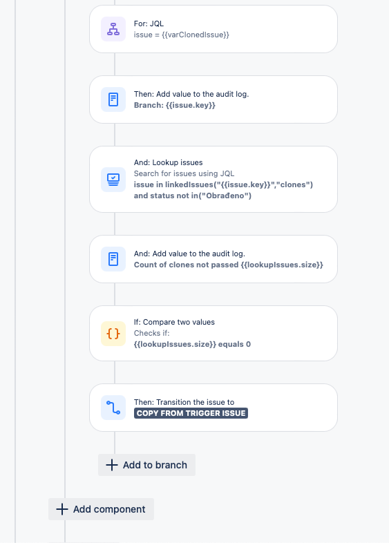

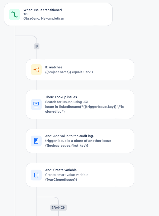

Luka Delić
October 30, 2024
Thank you very much! I have managed to automate it using your instructions and some modifications such as is cloned by/ clones, deleting [0] etc.
Thanks again!
