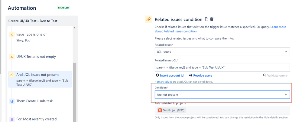

-right now I have a automation rule where when a task gets transitioned, it automatically creates a set of subtasks.
-the issues is when someone transitions to and from this state it will create a duplicate subtask.
-Is there a good way to handle the creation of this duplicate subtask/ these subtasks. One idea is to check if there is already a subtask with that name, and if so do nothing.
I understand there is a way to check if ANY subtasks exist and do nothing - this will not work here as there are already other subtasks that exist as part of the task at this point.
thank you for your help
I solved this by creating a "Related issues condition" and setting Condition to "Are not present".

You can use JQL condition, like
issuefunction in subTasksOf(key = {{issue key}} AND summary ~ "text_you_are_looking"
