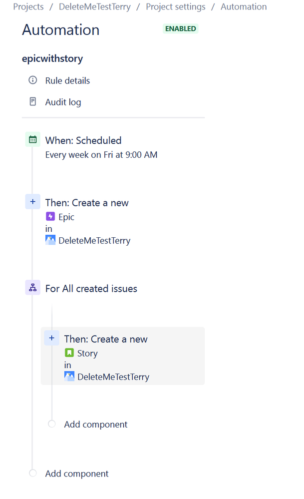

version 1:
calendar trigger
create epic
Branch "for all created issues"

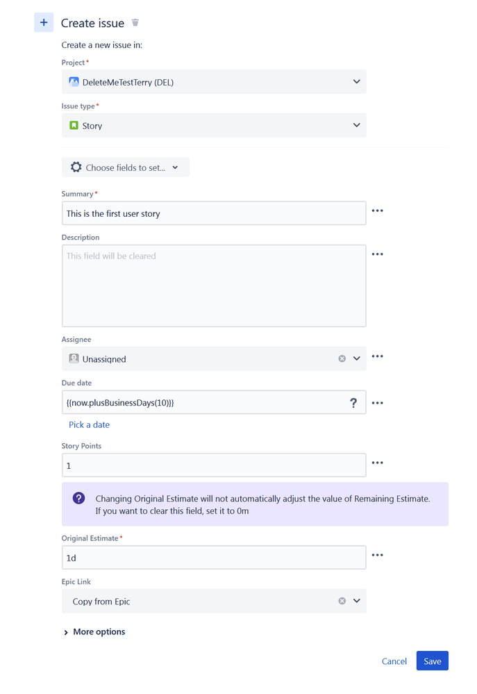

create issue type: story
Epic link: copy from epic
This Fails

Thanks for that information...
Am I understanding correctly that the problem is the linking is not working?
If so, try changing the set of Epic Link to "Copy from Issue", as that will use the current issue you are branching to: the just created epic.
