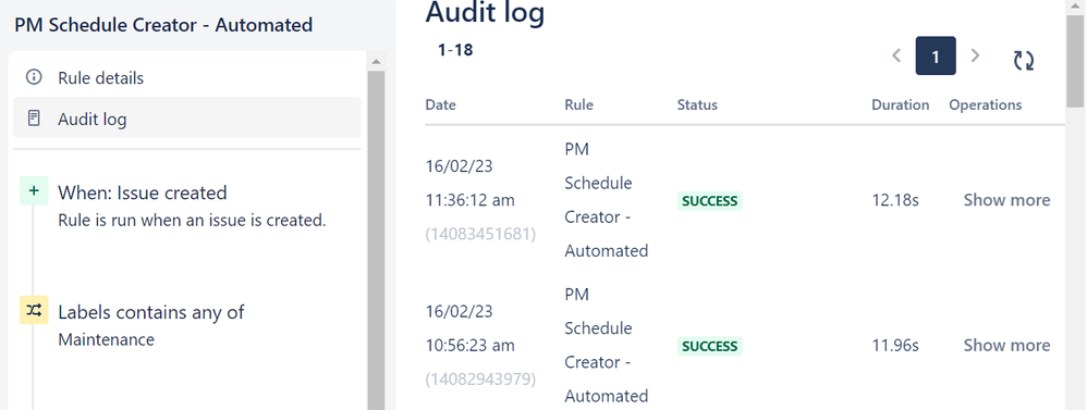

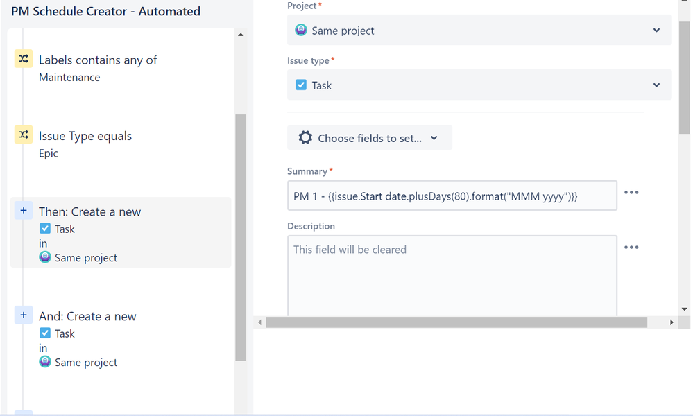

I created a few automation rules to complete custom date when the issue is created.  For example input the field Start Date, label must be Maintenance and issue type equal Epic when the issue is created.

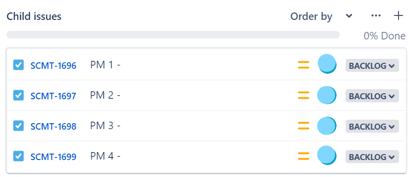

The audit log shows successful but there is no date in the field.  Any ideas why it's showing successful but the data isn't populating?
- Audit Log
- Result

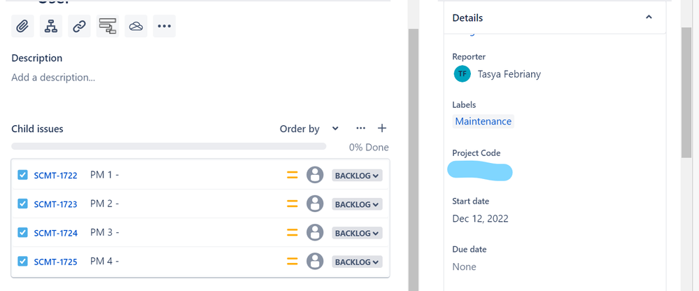

Tasya Febriany
February 15, 2023
I filled the start date field before, but it didn't work

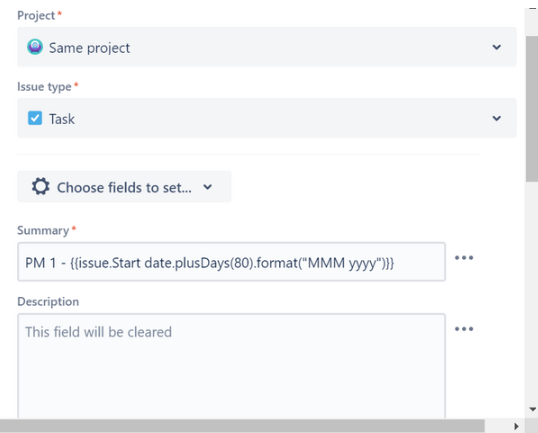

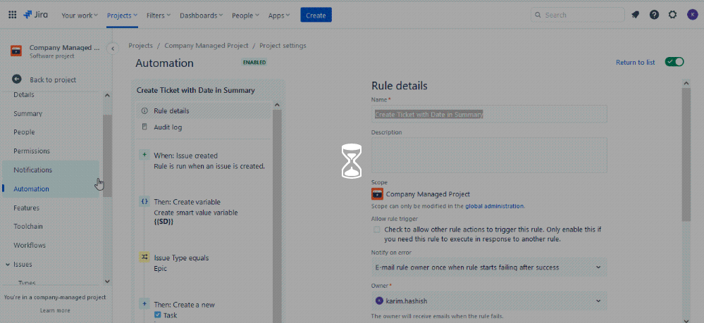

In fact the start date your are using in the function is referring to the Start Date of the task not the EPIC.
In order to solve that, you could store EPIC start date in a smart value then use it in your function --> check the illustration below
Let me know how it went for you.

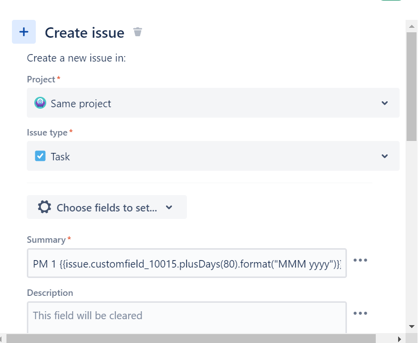

Tasya Febriany
February 17, 2023

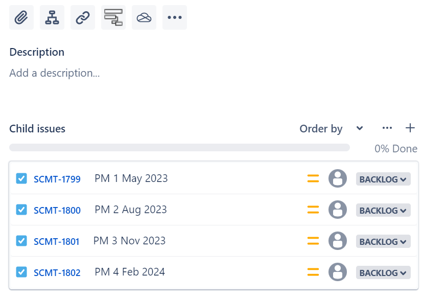

Thanks @Karim ABO HASHISH
I change the part of smart value from issue.Start date to issue.customfield_10015 and it worked!

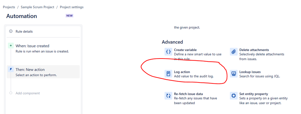

If, in the audit log, you click on the option, "Show more", you can see how the rule was processed, which can help in a case like this where the issue should meet the criteria but the action isn't happening.
Something else you can try for troubleshooting is to use the "log action" action to check that the smart value is working. Again, if you go into the "Show more" you should be able to see if the correct value is returned in the smart value, and then it's just to understand what / if something else isn't configured correctly.
