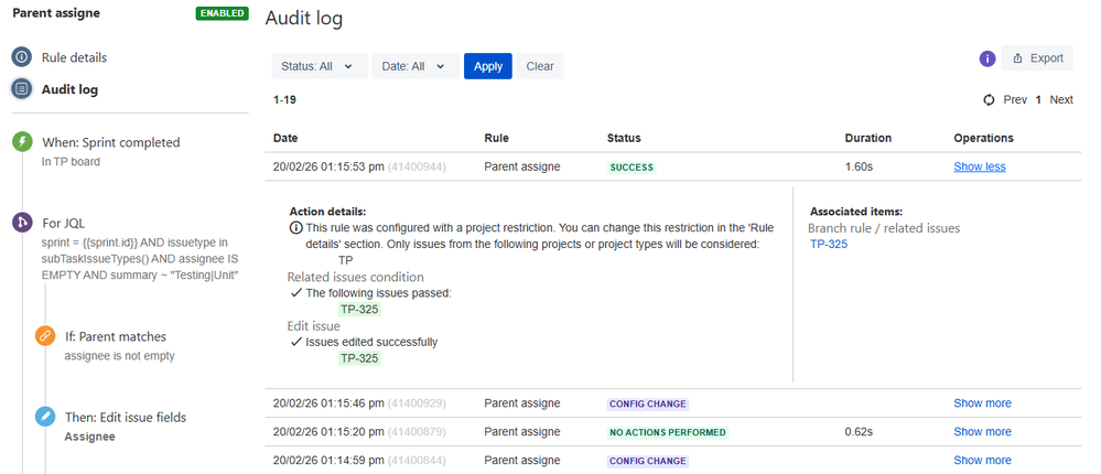

Gor Greyan
February 20, 2026
Hi @Pfdev11
Thanks for the question.
I tested this logic, and it works. Please also check on your side.
Trigger:  Sprint Started
Branch Rule: For JQL, put this JQL
sprint = {{sprint.id}} AND issuetype in subTaskIssueTypes() AND assignee IS EMPTY AND summary ~ "Testing|Unit"
Condition: Parent Issue --> Assignee is not empty
Action: Edit Assignee - {{issue.parent.assignee}}
Let me know if you have any questions.

Pfdev11
February 20, 2026
Thanks for the reply! I tried what you put, but the sub-tasks remained unassigned. Only difference is I have it when sprint started instead of completed.image.png
When I check the audit log, it says no related issues could be found under Branch rule / related issues.
Bill Sheboy
February 20, 2026
@Pfdev11 -- Subtasks are not assigned to a sprint normally as they "inherit" that condition from their parent issue, and thus that JQL would not find them.  Please see what I suggested to handle this situation.
