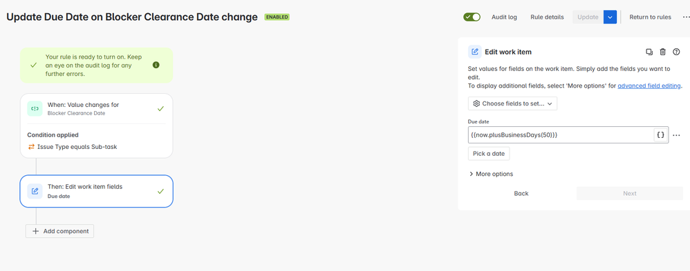

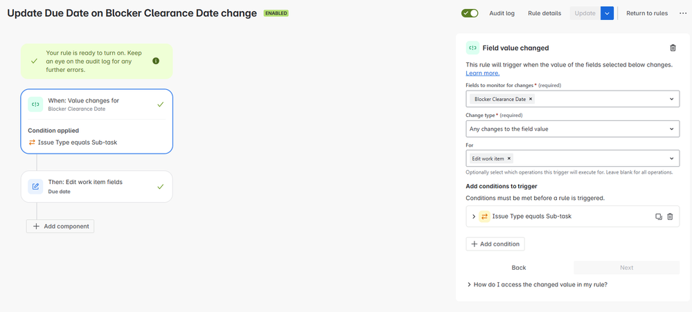

Thank you so much for your quick response. Firstly, you've helped me find where to add the Sub-task as a condition. Here are the screenshots below. This is just required for one single project at the moment and this is a company managed project.

I can see that you are now triggering the rule only when your work item is edited. You can play around with that setting (in the trigger) to make it fire on other events as well.
Your rule currently doesn't check what the value of your blocker clearance date is after the event. It might be removed e.g. and that will still trigger your rule as it is now. You might add additional conditions along with the sub-task condition to make sure it meets certain criteria. But what you need (not) to do there depends on your requirements, obviously.
Lastly, I see your calculation adds 50 days to now (which is the current date). Is that what you want? If so, I would imagine your rule should be doing what you need (if you fine-tune your conditions where needed).

Right now, you are not adding 50 days to the due date. You are setting the due date to 50 (business) days from today. If you do this 2x on the same day, that will indeed not make a difference.
If you really want to add 50 days to the due date, you would need to update your calculation to something like this:
{{issue.duedate.plusBusinessDays(50)}}
if that is what you are trying to achieve, obviously.
Lisa Bowman
August 7, 2025
Thanks Walter,
I can see what you are saying about my original calculation.
I did try the calculation you suggested but a date didn't appear in the Due Date field at all.
I think I might have to leave this one and come back to it another time.
Thank you for your help!
