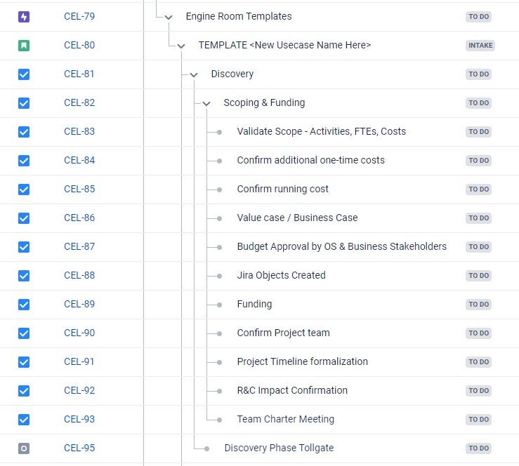

Here is a pic of the automation branches and steps thanksScreenshot 2023-08-21 151030.jpg

Step 1 Clone Template object with links (the links are also Template objects)Screenshot 2023-08-23 122433.jpg
Step 2 Clone each child link in the trigger and relink it to the trigger object
Step 3 Remove links to Templates
The end result should be the parent and children template objects cloned into a separate set of similarly linked objects. Thanks!
