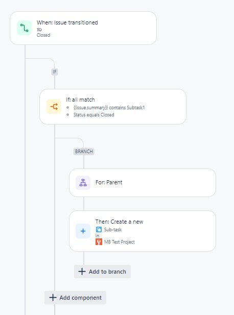

I have been successful in creating a Subtask when a single Subtask has been Closed, using the below automation;

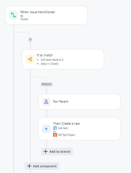

I attempted to follow https://community.atlassian.com/t5/Jira-questions/How-to-automatically-create-a-sub-task-when-other-two-sub-tasks/qaq-p/2343674  but didn't appear to have the same options to select from, that had been suggested in the comments. So, I ended up with the below automation (which isn't running at the point that I close 'Subtask1' & 'Subtask2');
I presume I've misunderstood a step, or have entered something incorrectly, but just can't get the automation to work. Any help would be great! Thanks
