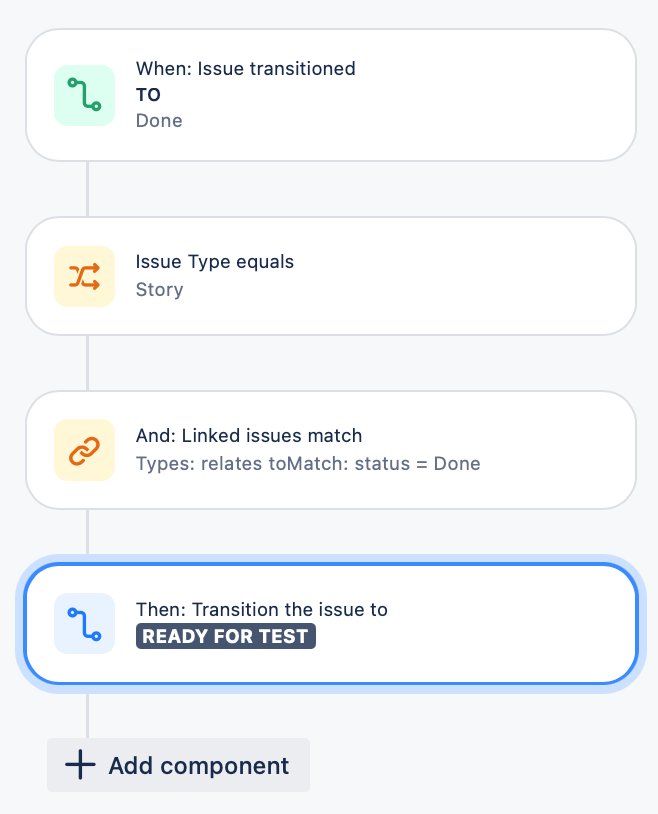

I am wanting to set up an Automation for a Jira Software project. We use Stories, Tasks, and Bugs. Stories are linked to the applicable Task and Bug tickets using the "relates to" link. I would like to create an Automation where once all linked "relates to" tickets are set to status = Done, the Story ticket is set to status = Ready for Test. I have attempted to set this up with the below Automation flow:Screenshot 2024-10-04 at 3.34.23 pm.png

Hi @Lachlan Ford-Browning and welcome to the Community!
For questions on automation rules, please do share full details from the automation rule and the audit log.
Apart from that - issue links have a different name depending on the direction they are defined at. Implements from the other end can be defined as Is implemented by to name an example. Make absolutely sure that the case you are testing with matches the actual criteria - from your screenshot:
  • the issue you transitioned is a story;
  • it should have linked issues with a relates to link;
  • all of these must be in status done
Only then, the rule tries to transition your original issue from status done to ready to test.
And then - of course - there must be an available transition in your workflow from Done to Ready to Test.
Apart from all the above, it is not a very common scenario that you would transition an issue from status Done into Ready to test. Done is usually the very end of a workflow.
Hope this helps!

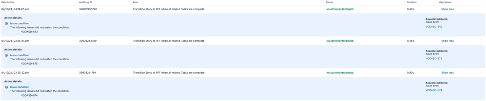

Please see the requested audit log from one of the actions performed below:
In these cases the tickets are Tasks that were linked to a Story using the relates to link, and were all transitioned to status = Done. This was confirmed in the Links section of the relevant Story ticket. The Story ticket did not transition to status = Ready For Test when all linked Tasks were transitioned to status = Done.
