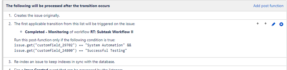

Vladimir Taranchenko
November 1, 2019
You cann't transite issue before  reindex post-function. Try to use listener or move post-function after reindex with manual reindex in code.

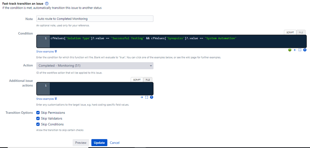

Ravi Sagar _Sparxsys_
November 1, 2019
Hi @jira_admin_cu
You can try Fast-track transition an issue as well. Take a look here.
Ravi

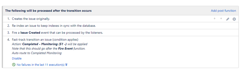

jira_admin_cu
November 4, 2019
Hi @Ravi Sagar _Sparxsys_ ,
   I used fast track post function, but it still not working.
The workflow is Open->Assigned->In Progress ->Completed Monitoring. When those two custom field values are mentioned while creating the jira ticket, the workflow transition directly goes from "Open" to "Completed Monitoring". Could you please me on this?
jira_admin_cu
November 4, 2019
but the workflow has "Completed - Monitoring" status.
It directly going to "Assigned", but not to "Completed Monitoring" ,and i tried with "In Progress" status, its also same. In Progress and Completed Monitoring has two transitions names with different ids. is this causing the issue ?
lummalaneni@spscommerce.com 847x48087x1 1umxvsk 183.83.224.47,172.31.37.2 /secure/QuickCreateIssue.jspa [c.o.s.c.jira.utils.WorkflowUtils] In-depth checking of each condition follows to determine why the action was not allowed.
2019-11-04 14:07:45,510 http-nio-8080-exec-8 ERROR lummalaneni@spscommerce.com 847x48087x1 1umxvsk 183.83.224.47,172.31.37.2 /secure/QuickCreateIssue.jspa [c.o.s.c.jira.utils.WorkflowUtils]
    It seems that you have tried to perform a workflow operation (Completed - Monitoring) that is not valid for the current state of this issue (RT-58214). The likely cause is that somebody has changed the issue recently, please look at the issue history for details.

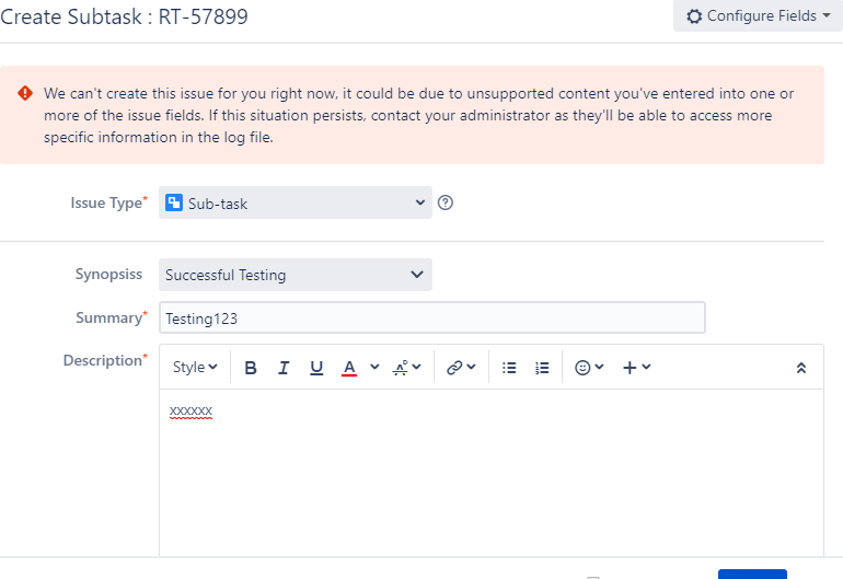

jira_admin_cu
November 1, 2019
I tried with "Transition issue" post function on create screen, but getting error while creating the subtask. Please attached screen shots for your reference and please correct me if i am using wrong scripts. Thank you11.PNG22.PNG
