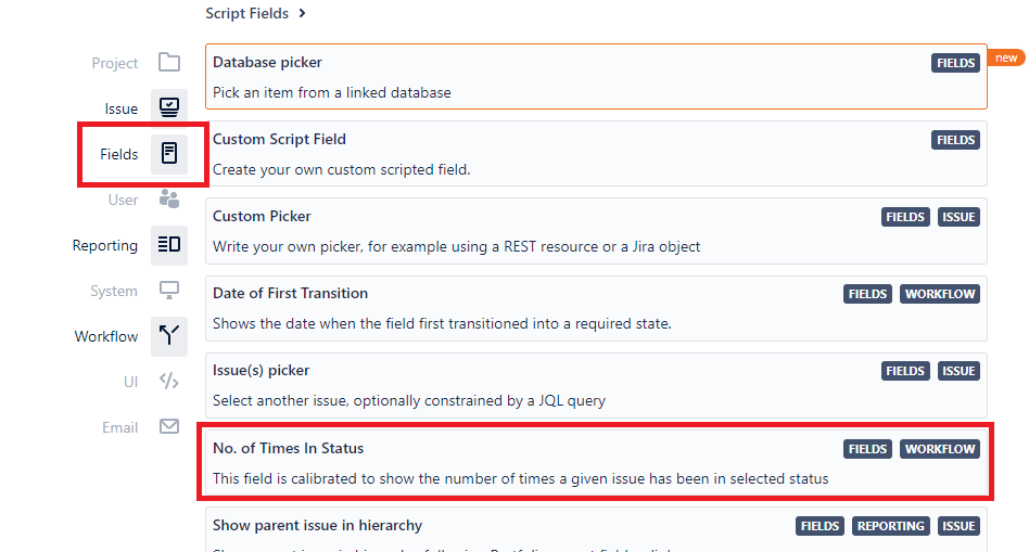

jira_admin_cu
April 26, 2022
Hi Team, Thank you for all your quick responses. I found this in script runner scripted fields. Here you can count the number of times in status.
