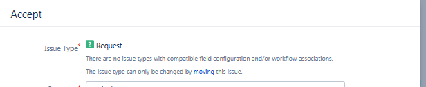

I've actually found a viable and easy solution to this:   I created a new screen that launches on state transition and on that screen is the Issue Type field.  When launched, I get the below text with a link to move the issue.

Where did you find the Move-link? Is there any "default" link, or do you get it from the issue with some logic?
Laurie Sciutti
December 6, 2019
Hi Ann ~ the move link unexpectedly appeared automatically for me when I created the new screen and transition to launch the screen.
