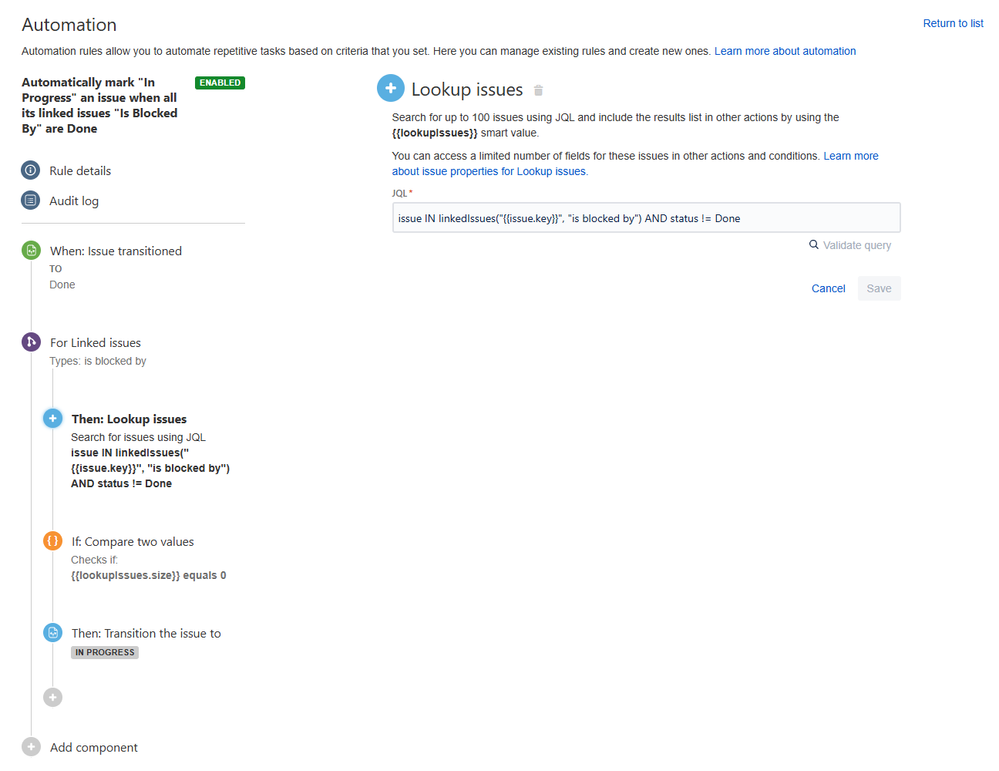

Hi Team,
Automatically move the Defect Issue Type ticket to "In Progress" status when all its linked issues "Is Blocked By" are Done from tickets that are related to any other issue type. I used the automation rule below, but the ticket defect's status is not changing, even though all the linked tickets are done. Did I miss anything in this automation rule?

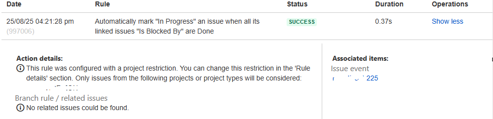

Can you share with us the information you are getting in the rule Audit Log when you mark the last of a one of the "is Blocked By" linked issues to Done?
The output when you set any of the "is Blocked By" linked issues to Done, whether the first, second, or last, would also be informative to helping us debug your issue and advise you.
jira_admin_cu
August 26, 2025
Hi @Trudy P Claspill ,
Thank you for the quick response, The ticket in the audit its showing is for blocked by ticket not the main ticket, but it should change the main ticket, when the all blocked by tickets are changed to Done.

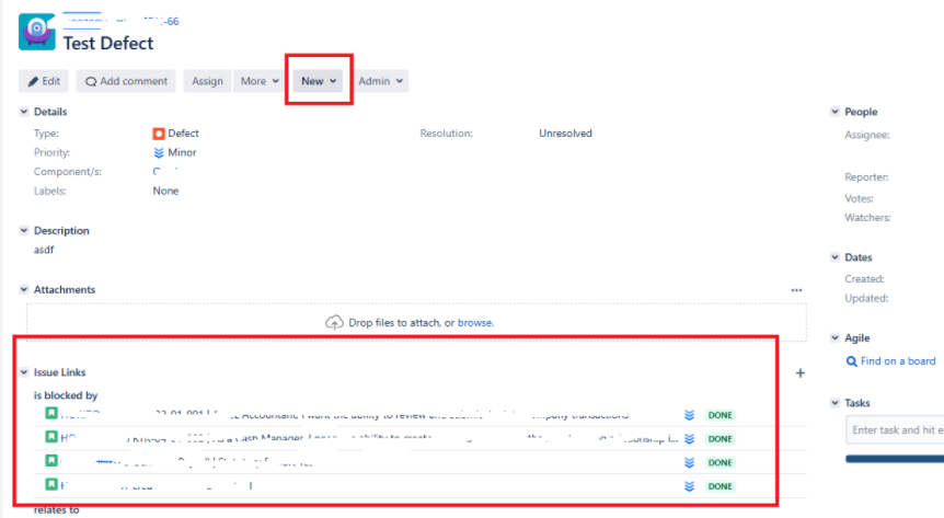

It may be help you in the requirement.
 if all linked tickets with "is Blocked By" are in the "Done" status, the main ticket, should move to In Progress status.

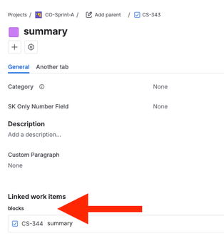

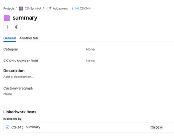

When you view the details of one of the issues under the Issue Links area, in that issue's Issue Links area the "main" ticket will be listed. What is the link type description shown there, describing the link from the blocking issues to the issue it blocks?
Example:
View from main issue:
(my images are taken from Jira Cloud so they may look a bit different)
View from the issue that blocks the main issue:

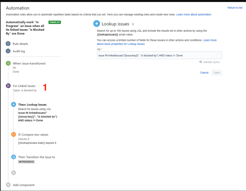

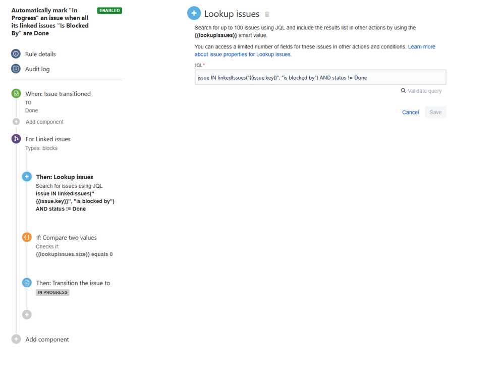

In your rule at the step I labeled with "1" you need to use the link description that shows up in the issue that Blocks the main issue.
jira_admin_cu
August 27, 2025
Thank you for the correction. It's working now! I changed the linked issue type from "Is Blocked By" to "Blocks."

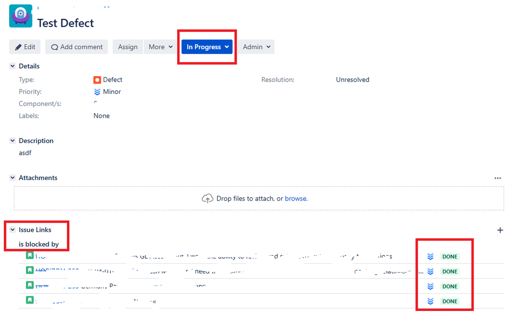

All tickets of the Defect issue type that were linked as "Is Blocked By" have been moved to the "Done" status. The Defect ticket will be moved to the "In Progress" status. To ensure this works, we need to add "All" to the "In Progress" status.
The Automation rule for everyone reference is :
And The "Defect" ticket automatically moves to "In Progress" when all "Is blocked by" tickets are marked as Done.
