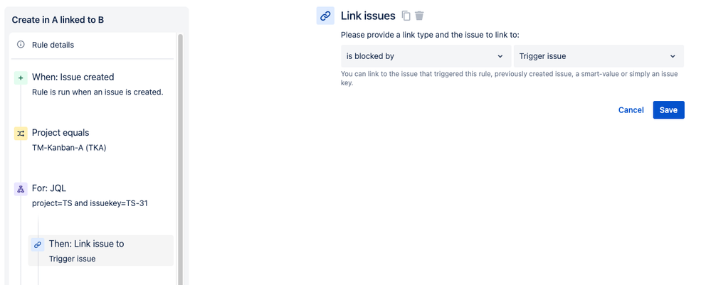

This requires a multi-project rule. Multi-project rules can be created only by Jira Administrators.
The rule would looks something like this:
The rule is triggered when an issue is created in one of the projects specified as in scope on the Rule Details page.
The first Condition checks that the issue creation that triggered the rule was for an issue in 'Operations' project (different name in my example).
You then create a Branch / Related Issues / JQL component and insert a JQL statement to find the issues in your 'Rental Properties' project to which you want to link the newly created issue.
Inside that branch you add the step to link each issue found by that JQL to the issue that triggered the rule.

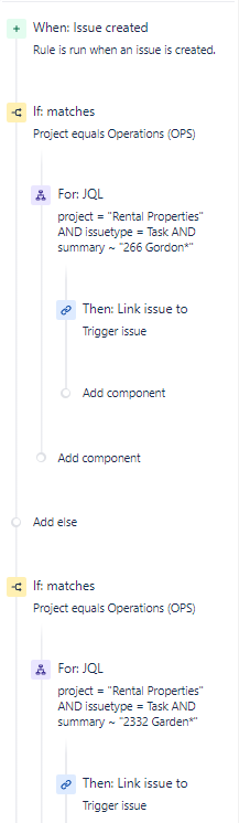

this rule works! however the issue that i am running into is with the wildcard. i had to test it with a practice with this JQL query:
" project = "Rental Properties" AND issuetype = Task AND summary ~ "266 Gordon*" "
i had to add information of a specific issue in order to match them. is it possible to have them match so long as they are similar?

Currently im trying to link new issues to my managed issues. IF they are named similarly. i even tried adding a "IF" condition to seperate them but they are all being linked no matter the difference in summary so long as one matches it links all related queries
In the rule you have shown there is nothing that is comparing the Summary value of the trigger issue to the Summary value in the related issues. That is why all related issues are being linked to the trigger issue.

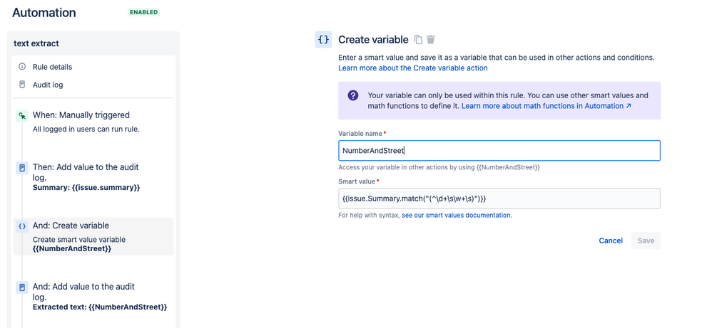

In your Automation Rule you can pull the first two "words" from that Summary using a pattern matching function and store them in a variable.
(You can find information about manipulating text values in Automation Rules here.)

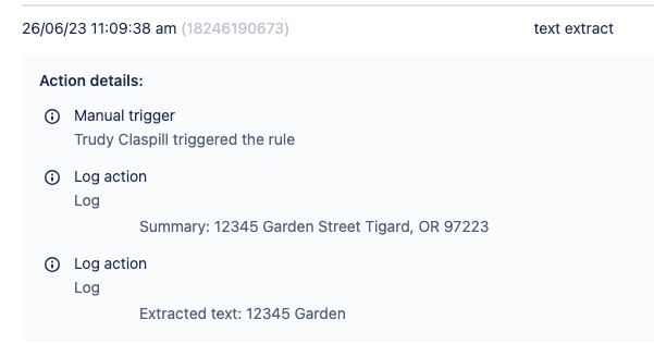

Here is an example. In this rule I will print the trigger issues Summary field, then create a variable and extract the first two "words" from the Summary, and then I will print the extracted text that I stored in the variable.
For ease in copy/paste, here is what I put in the Smart Value field:
{{issue.Summary.match("(^\d+\s\w+\s)")}}
Here is the result in the rule execution audit log.

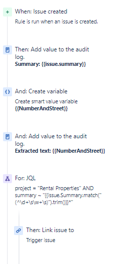

@Trudy P Claspill you are amazing!! i had to do a bit of research but i was able to remove the space in between the smartvalue and the wildcard and the solution was to use the "trim()":
"project = "Rental Properties" AND summary ~ "{{issue.Summary.match("(^\d+\s\w+\s)").trim()}}*""
