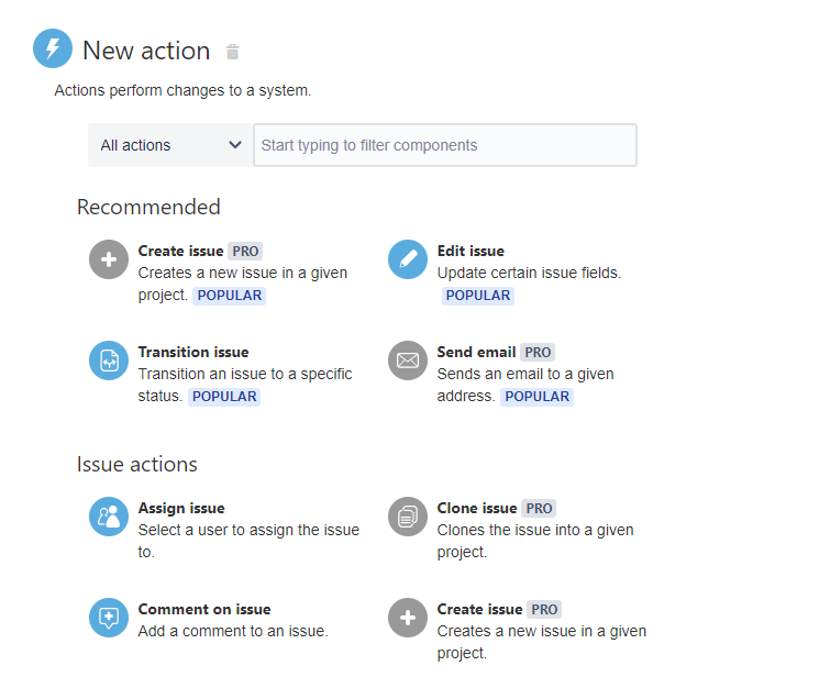

According to your suggestion, I have checked. The create issue and clone issue on automaiton we use are gray, which seems to be caused by the license expiration. Is there any other way to realize it

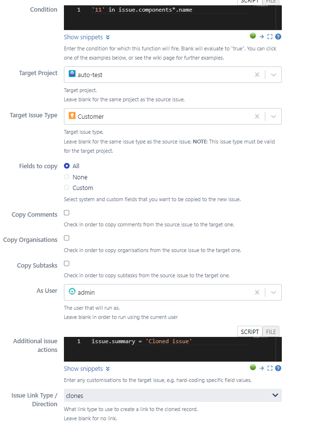

I encountered some problems in the configuration. The condition I set is to trigger when the problem is created and the module field is "11". The relevant configuration is shown in the figure
When I tried to test, I found that the plugin would constantly create new monads, which even affected the use of jira. At the same time, I found that the monads created were not linked together, is there a problem with my configuration? Can you tell me how to optimize it

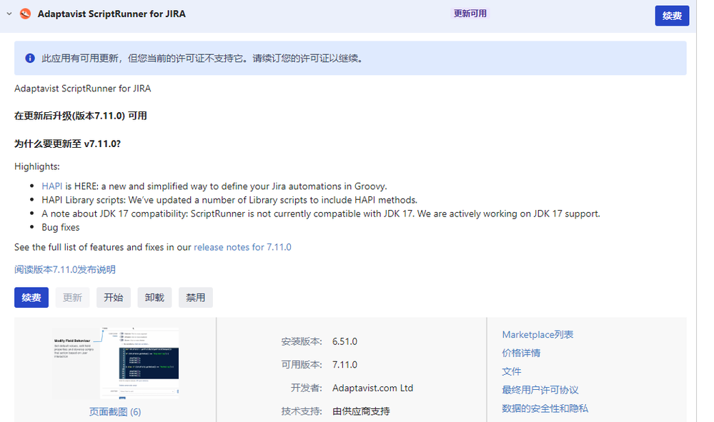

I did not see the relevant error. In addition, I found that the same Settings run normally in the test environment. Is this related to the version of my plug-in? The version of the plug-in in the test environment is 6.24.0
@arno if you have a way to do a roll back in test I would suggest upgrading test and seeing if it is the issue. If it is you would need to submit a support issue to Adaptavist. If you do not have a way to roll back test I would suggest submitting a support issue to Adaptavist.
