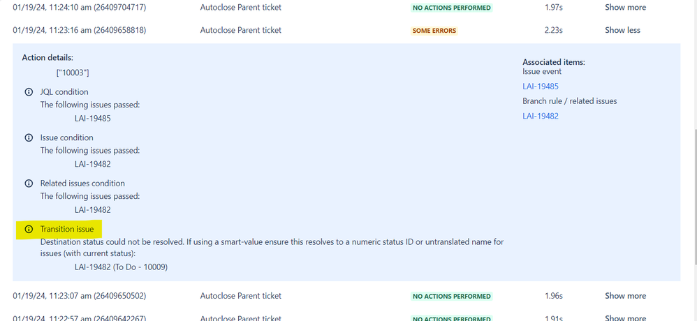

I understand what you're saying when denoting that sub-tasks are relating to the level as a whole. When I tested referring to the linked post, I got this error:
In fact, this impacted a separate Parent ticket I was not working on and it actually transitioned the Parent ticket to Done even though there were still Sub-tasks in the "To-do" status.

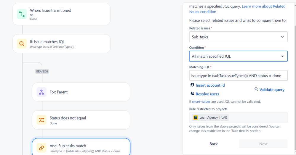

So my next step was doing as you describe (JQL). Here is my setup:

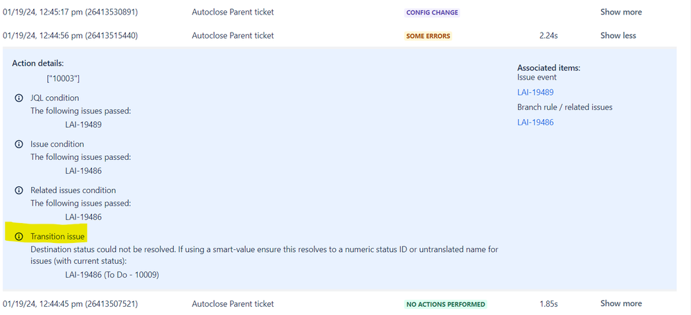

Interestingly, I get the same exact error as in my first screenshot when going to the Audit Log:

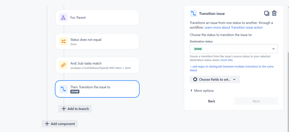

For good measure, this is how my current automation ends. I did not include the full screenshot in my previous post.Screenshot 2024-01-19 130653.png

Hi @Justin Jones ,
The error suggests that the transition to the Done status is not available for the parent issue you are trying to update. Most commonly, that it is because there is no transition from the issue's current status to Done (the condition status != Done also returns issue in To Do or Backlog statuses).
Another thing I've seen on several occasions is related to team managed projects. Each project may have its own Done status, leading to confusing situations where one Done status is not the other one with the same name.
Finally, it could also be that conditions or validators on your workflow may block the issue from moving to that status automatically. Of course, it's difficult to judge from a distance what may be happening in your specific case, but hopefully these are some useful pointers.
