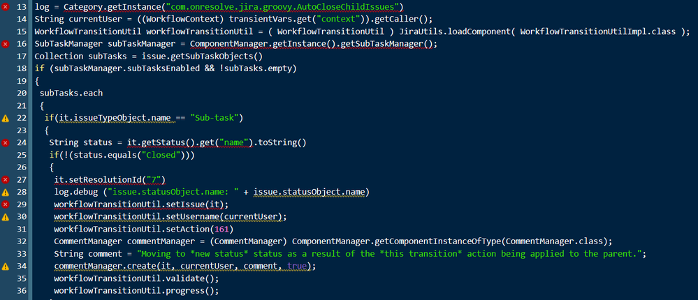

If I copy/paste th code in my JIRA I got a lot of unknown method error as you can see in the screenshot jira.PNG
I also copy/paste all the needed imports.
Do you have any idea why not working in my context?
Sorry, I'm a real beginner...

Can you please post the code on gist.github.com and share here, it seems you are missing some import statements.

I still have the same issues, when I copy paste the code you linked to me I got a lot of unexpected error.
Here is a link to gist:
https://gist.github.com/anonymous/60c80f93577b7d2b3e50fea932c6b68a

The problem is that with gist you don't see the errors I got while pasting in JIRA.
Nevertheless you can see that I copy the same code.
When paste into JIRA I got a lot of  "Cannot find matching method"

You can't use the exact same code, as the code is a reference which is using the "transition" id of close for sub-tasks but in your case you have to move the sub-task  from waiting to "To do" thus you have to use the transition ID of your workflow and change the code as per your requirement.
Tarun Sapra
August 2, 2017
I have updated the code in the gist link and it should remove some of the compile errors, but for the rest you have to go through the code and update as per your workflow and transition ID.
