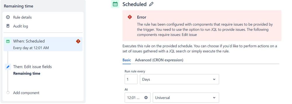

Thank you for the smart value. So after trying the query, you can see that Based on the picture below, it’s now asking me to run the JQL in order to edit the issue. I have been playing around with Chat gpt to solve the last piece of the puzzle but without success.Capture8.JPG

That error is describing the problem: the rule is trying to edit issues but none were provided.  You would need to decide which issue you want to update, write a JQL statement to find them, and then use that JQL in the trigger.

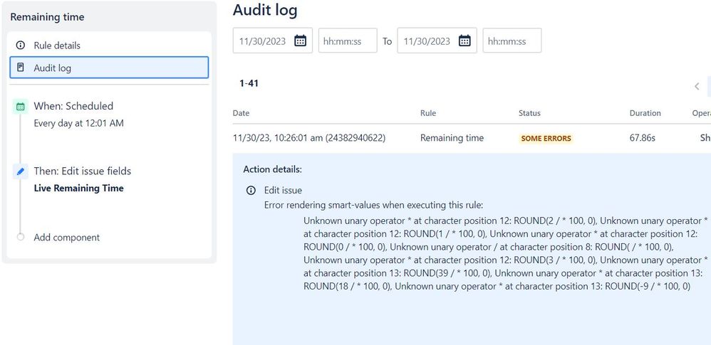

Now that i entered the issues status i want the automation to edit, it's giving me this error message.

That error is indicating the denominator in the expression (after the divide operator) is null...and so perhaps one of the fields is empty or the smart values are incorrect.
Please copy and paste the expression you are using to set the "Live Remaining Time" in a message.  That will help us review the cause.

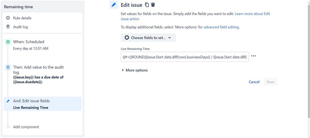

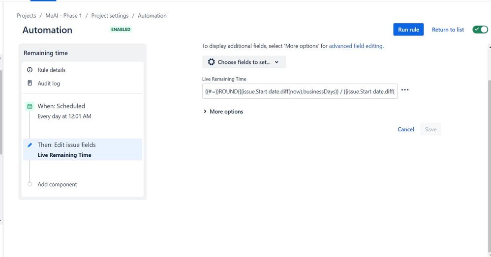

I see, I am using the smart value you provided me before to set the "live remaining time" in the "edit issue" component.
{{#=}}ROUND({{issue.Start date.diff(now).businessDays}} / {{issue.Start date.diff(issue.duedate).businessDays}} * 100, 0){{/}}

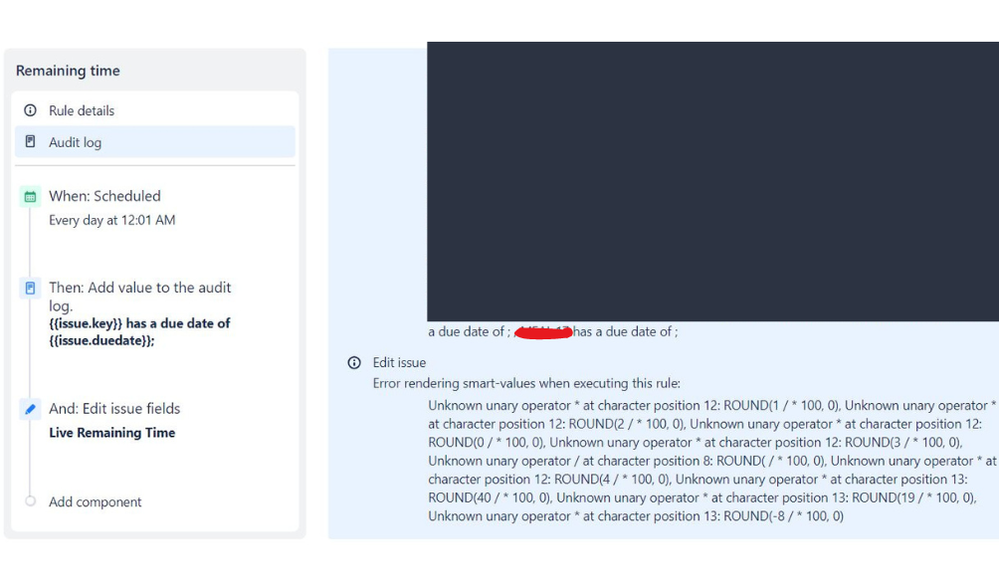

Thanks, Quentin.  Based on that information, the value issue.duedate appears to be null.
Let's write some values to the audit log to confirm that using the Log action:
{{issue.key}} has a due date of {{issue.duedate}};
I suspect the smart value is different for your instance, as my answer was based on Jira Cloud.  Are you using Jira Cloud, Server, or Data Center?

When adding an extra step to my automation, it has been able to succesfully pull the datas from the issues, but the same unary operator remain. Did i correctly implmeented it within my automation?

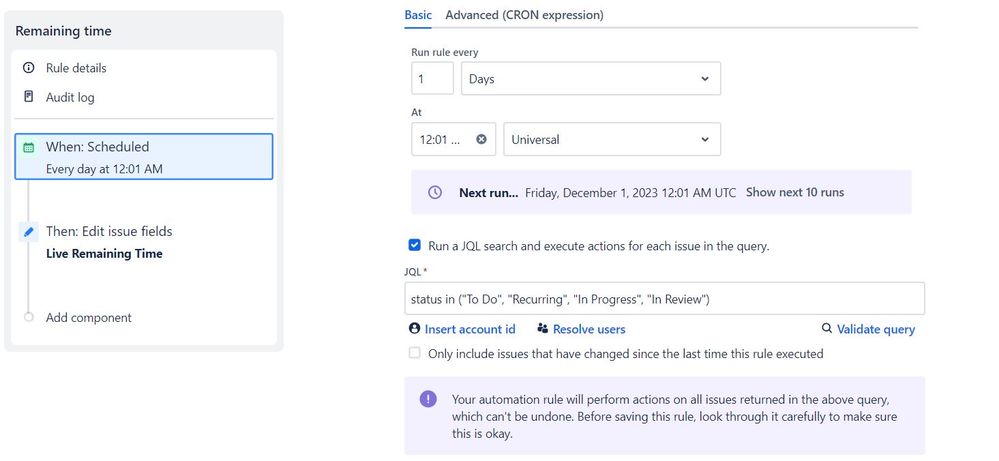

Fist i am using a "shceduled" trigger set for everyday at 12.01am
The jql i'm running for it is: status in ("To Do", "Recurring", "In Progress", "In Review")

then final step, i'm using an "eddit issue field" action. I've picked my field called "Live Remaining time" for it and the smart value in it is: {{#=}}ROUND({{issue.Start date.diff(now).businessDays}} / {{issue.Start date.diff(issue.duedate).businessDays}} * 100, 0){{/}}
