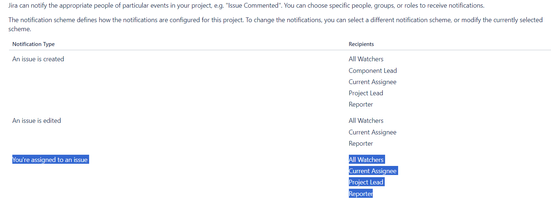

Think the most straightforward solution to this would be to edit the notification scheme of the project where the automation rule is running. If the rule is scoped to several projects, you may need to edit several notification schemes.
From what I understand, you should get the desired functionality by removing the Reporter from the You're assigned to an issue option in the notification scheme:
Let me know if that works for you!

Thank you for the suggestion but wouldn't that prevent Jira from emailing me every time I were assigned a ticket? I only want the notification to be suppressed when I am being assigned a ticket that I myself created.

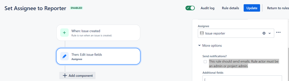

Hey @Craig Silver! As you mention, the project default assignee would apply to all issues, even if they do not have a component selected. If you do select a component, Jira will override the project default assignee to whatever you select for that component, which can be the Component Lead, Project Default, Project Lead or Unassigned.
So, in conclusion, if you need more granular issue assignment upon creation, go with components, otherwise, the project default assignee is fine.
And yes - switching to default assignees sounds like a good idea. I do want to ask a question however: Do you mean to suppress all email notifications when you become assignee of tickets you've reported, every time, or do you mean only to suppress the initial assignment email notification that occurs right after emial creation? Because if that were the case, you may be able to get away with it by de-selecting the "This ruke should send emails" option in the automation rule "Edit issue field" action:

To answer your question, I guess I want to suppress email notification when, and only when, the user assigning the ticket and the new assignee are the same, plus (also suppress notification) when the user being assigned the ticket is the same as the user creating it. Admittedly, I'm confused as to what setup steps to take to achieve that.
