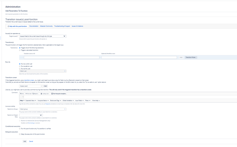

@jonathan_ghellere
Use can try with JMWE plugin Transition Issue(s) Post-Function option to transition the current issues based on the Linked Issues transition. This Post-function has to added in the Linked Issues workflow
