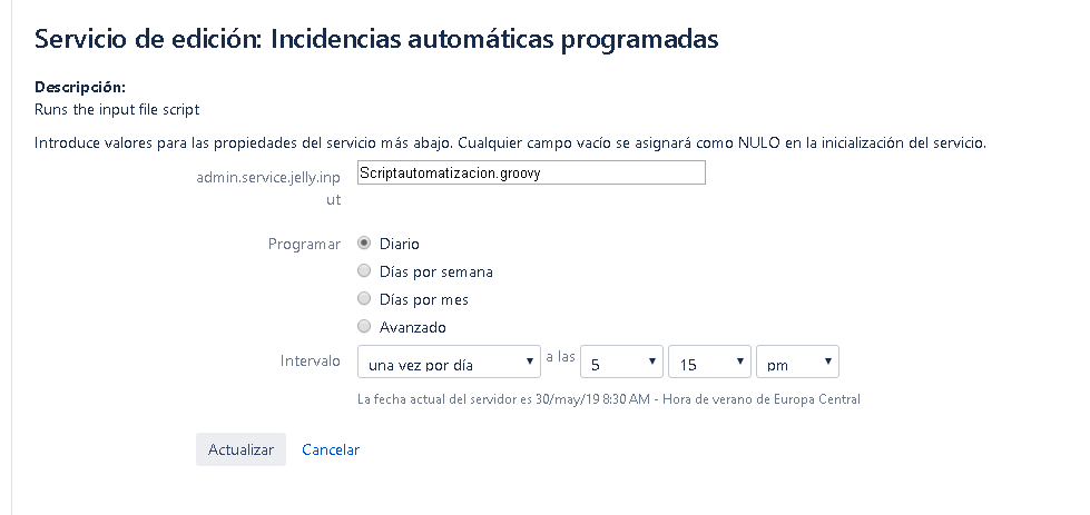

I have other question:
I have programmed a daily service to execute the script, in input file I have put the name of the script (example.groovy) and it is saved in (jira/scripts/ xample.groovy) but it does not do anything, the script works from the console but from file not . Can you help me?
You are welcome !
What do you mean by "a daily service" ? Best would be to include a screenshot of your configuration.
Antoine
The script has written in .log, the service does work!!
But the problem is authentication.
The error is: an anonymous user can not create an issue.
It makes sense since the user to execute the script with is not configured. Please try :
def user = ComponentAccessor.getUserManager().getUserByKey("berry_a");instead.
