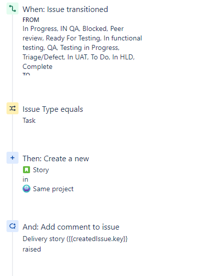

Hi John.
The story is being created via automation. Screenshot of the rules are below
John Funk
January 30, 2023
Very good - see my suggestion above about adding the branch.

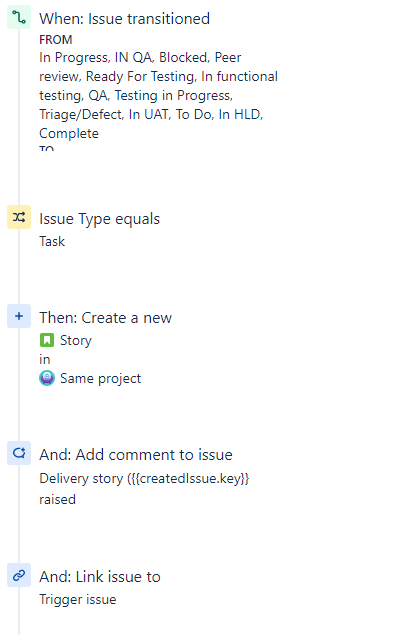

Chris.Buckley
January 30, 2023
I have tried this, also tried it with the new story.
Any other thoughts?
John Funk
January 30, 2023
Can you share your new rule and what is not working with it?
Chris.Buckley
January 31, 2023
See above. The link does not appear in the new story. I also dont get any failure reports so not sure why this is happening
John Funk
January 31, 2023
Try adding the Branch for Most recently created issue before the last step. Make sure the last step is under the branch.
Chris.Buckley
February 1, 2023
This worked! Thanks so much John.
