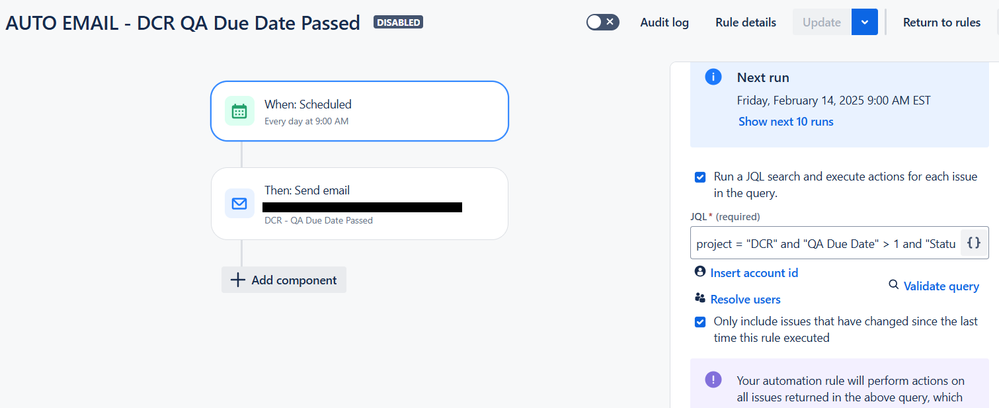

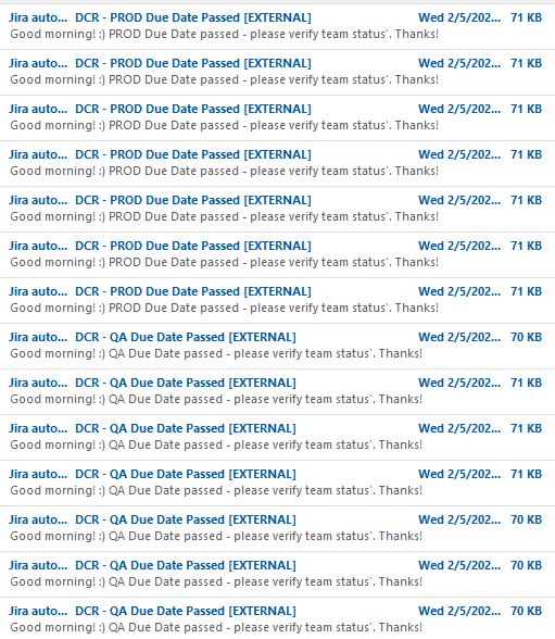

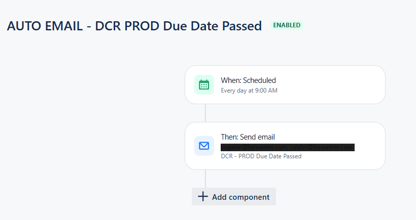

We created a JIRA automation rule to run in the morning and send an email when a custom field 'date' is passed the date. Here' the JQL:
project = "DCR" and "PROD Due Date" > 1 and "Status" != "DONE"
project = "DCR" and "QA Due Date" > 1 and "Status" != "DONE"
When I validated the rule, 10 issues are found. However, I received 7 emails, for each custom field JQL, and the dates passed are note the same.
Would anyone have an idea why we are receiving so many emails?

Hi @Amanda Sugatan -- Welcome to the Atlassian Community!
The reason you are receiving so many emails is the JQL is in the Scheduled Trigger, and that will process an email for each issue found.
When you want to send one email containing a list of issues meeting the criteria, please try:
  • use a Scheduled Trigger with no JQL
  • use the Lookup Issues action with the JQL
  • filter down to what is needed, and branch to send the details using additional Lookup Issues actions
Here is an article from Atlassian that outlines the steps, which can be modified for the specifics of your scenario:
https://confluence.atlassian.com/jirakb/automation-to-send-email-only-once-per-assignee-1310985609.html

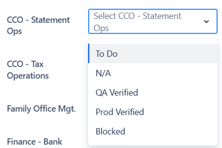

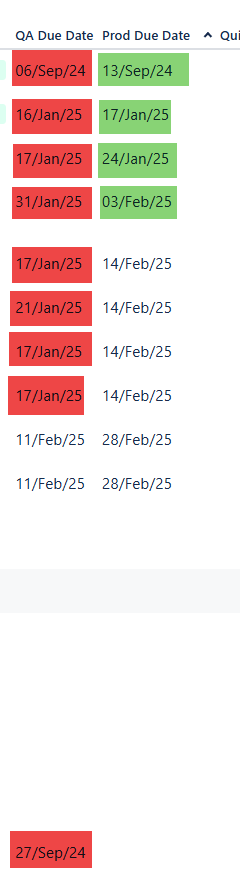

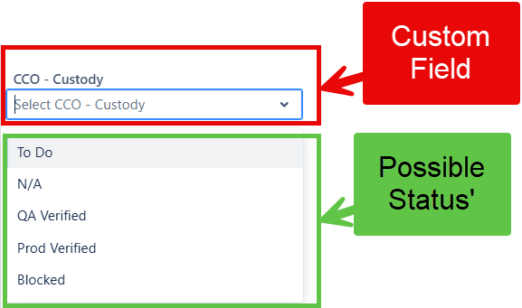

We created a project to house issues for requests that impact about 30 teams (possibly involving 100+ people). Instead of creating subtasks for each department, we created about 30 custom fields for each team to ‘sign-off’. These custom fields have a dropdown of Statuses (ex: QA Verified, PROD Verified, TO DO,N/A) which is updated by a team manager. This is how my team keeps track of where each team is on their sign-off.
For my team specifically, we are subscribed to filters which is helpful! Currently, all the watchers are using the built-in Jira notifications – this is working great.
Originally, when I was testing the email – the rule validated, but I was getting a separate email for each issue – this is way too many emails and didn’t display which ISSUE it was referring to – so one email with a list of all of the issues would be way better!
The ideal scenario would be ..if the QA due date for these fields passed, and teams signoffs are not QA verified, an email can be sent to those specific teams that are not ‘QA VERIFIED’ as a reminder. Is this at all possible? In this case, it would be even more awesome to group the requests together where one team status is not QA verified, but if emails must be separate, that’s okay too.2025-02-14_00-34-25.PNG2025-02-14_00-23-23.PNG

Thanks for the additional info, and...30 custom fields for 30 teams!  Wow, that's a lot for progress tracking.
That field appears to be a single-select, option field, correct?
Next question: why not use a Status value and a board rather than the custom field?

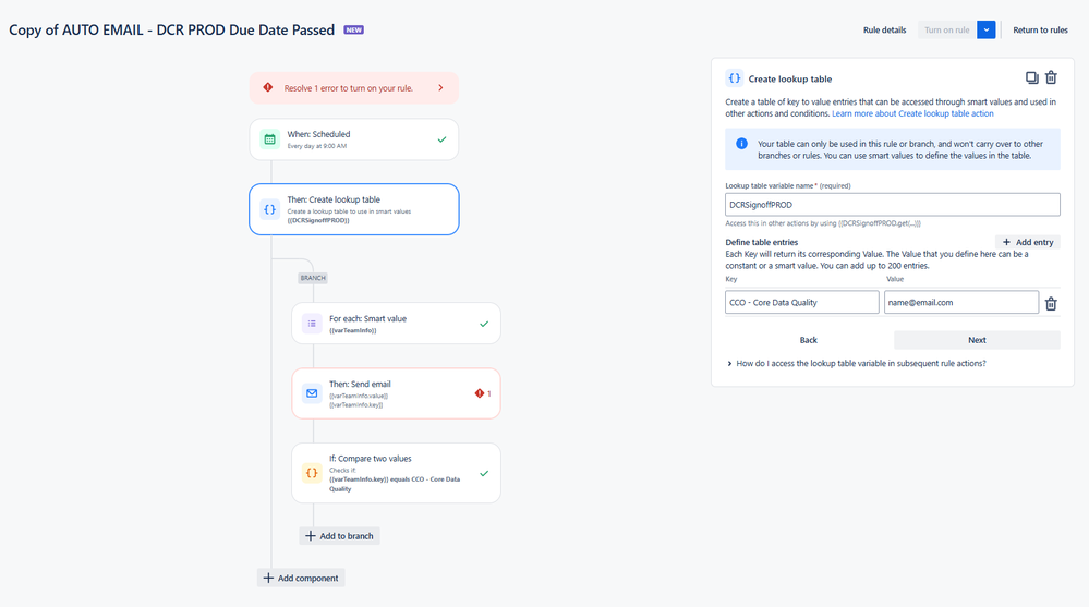

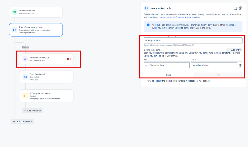

I'm trying the second solution. for the Key - does this have to match the field name? EX: CCO - Statement Ops? And for multiple team member emails - would this mean multiple lines? Thanks!
Amanda S
March 20, 2025

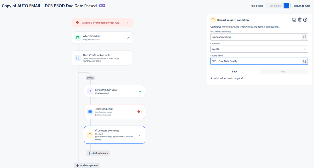

Also - does this look right to you? I'm getting an error, could you tell why? 2025-03-20_23-51-17.PNG

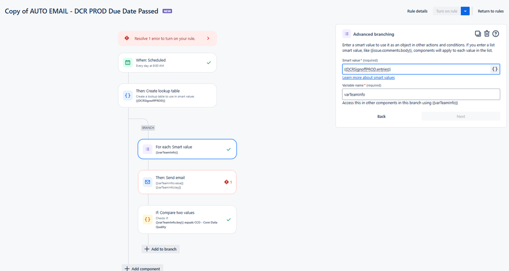

Hi, @Amanda Sugatan
That error indicates some type of problem with the Advanced Branch setup.  Please post an image of that one for context.
When one wants to iterate over the rows in a Lookup Table, use the entries function to access the list of values.  For example:
  • action: create table named DCRSignoffPROD
  • advanced branch:
    • variable name: varTeamInfo
    • smart value: {{DCRSignoffPROD.entries}}
      • in the branch, to access the table row's elements use:
        • {{varTeamInfo.key}}
        • {{varTeamInfo.value}}

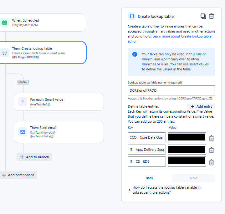

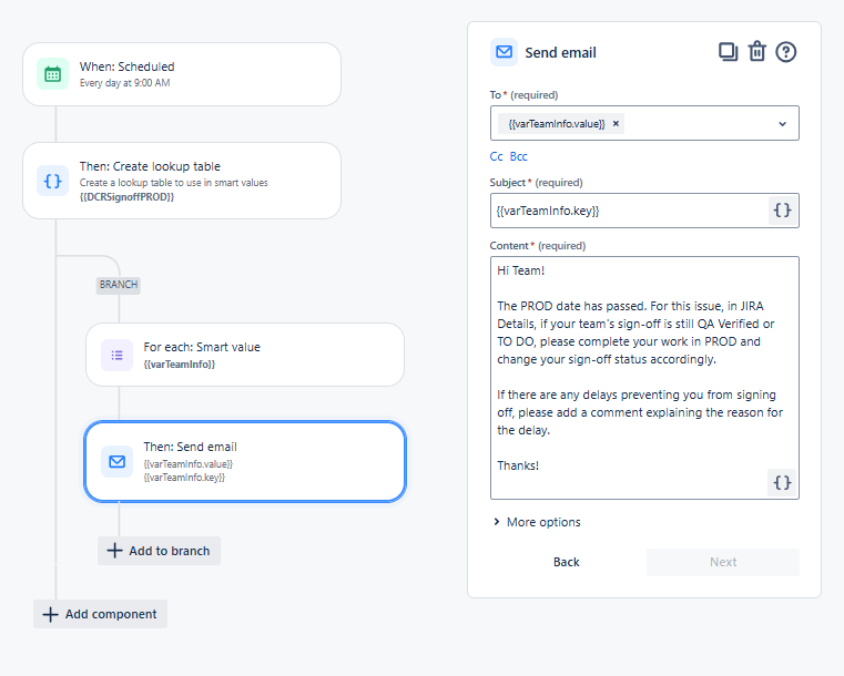

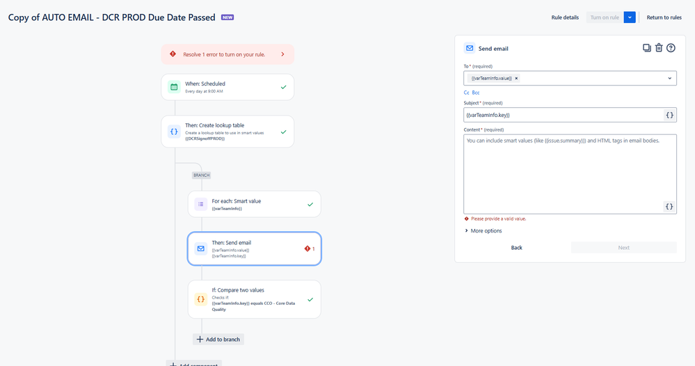

I love learning the details, what does {[varTeamInfo.key/value}}  do?
here's the updated rule - it looks like this is returning with an error, would you share a suggestion on how we can fix?
2025-03-25_16-29-14.PNG2025-03-25_16-29-37.PNG2025-03-25_16-26-04.PNG2025-03-25_16-30-00.PNGAlso, does the rest of the rule look OK?
Thanks so much for your help!!
Bill Sheboy
March 25, 2025
That looks better; the missing part with the error is because the Send Email Action does not have any Content in the message to send and that is a required field.
Regarding those smart values I noted earlier...
  • You have a lookup table named DCRSignoffPROD and that currently has one row
  • Each table row has a "key" and a "value" element
  • In your advanced branch, the rule loops over the rows with {{DCRSignoffPROD.entries}} and names each row {{varTeamInfo}} as it loops
    • Thus to access the key from the row, use {{varTeamInfo.key}}
    • And to access the value from the row, use {{varTeamInfo.value}}
Also...your table only contains one row, which matches your condition inside the branch.  What is the purpose of that condition test?  Is it just an experiment?

I updated these two sections and deleted the extra condition (I thought I needed it to be honest) lol .
Question - how can I refine the rule to looks for the teams and their values based on the due dates? does this rule still need adjustments for the scenario we spoke of earlier?
